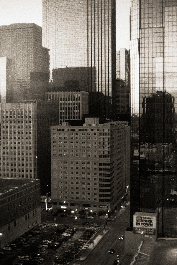

I have always loved this film in Rodinal developer, 1+25. Develop for a looooooooooooooong time to get adequate contrast, and then print big. A good friend of mine made 30x40inch prints from 35mm Delta 3200 negatives, and they look fantastic.
I've only gone to 16x20, but absolutely love the results.
Attached are two examples of 35mm Delta 3200, one low contrast evening shot, and one high contrast night shot. Both are scans of prints from Rodinal 1+25 negatives.
