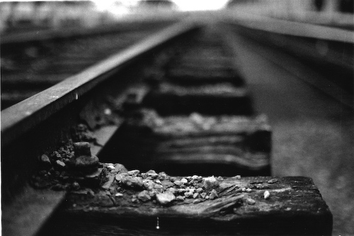

I'm still fairly new at this but I've been using ID-11 with great success. HP5 at 1600 looks great to me in ID-11. Pretty contrasty but not terribly grainy, certainly not compared to the fun sandpaper look I get with Delta 3200 @ 12500....
Edit: Sample attached of HP5 @ 1600 in ID-11

Thanks to everyone so far. Chris, I love that shot. Did you use a red filter for it?
Thanks!!! It's my current favourite shot :smile:
No, this was shot unfiltered. At 1600 I find HP5 is fairly contrasty and this particular shot when printed on grade 2 seems to really crank the contrast... This was taken on a recent photowalk, two of us swapped lenses for the day, she got my 80-200 2.8 and I got her 50 1.4, at the end of the day I didn't want to give it back !!!
Her shots of the same thing on d*g*tal looked extremely flat and boring by comparison
