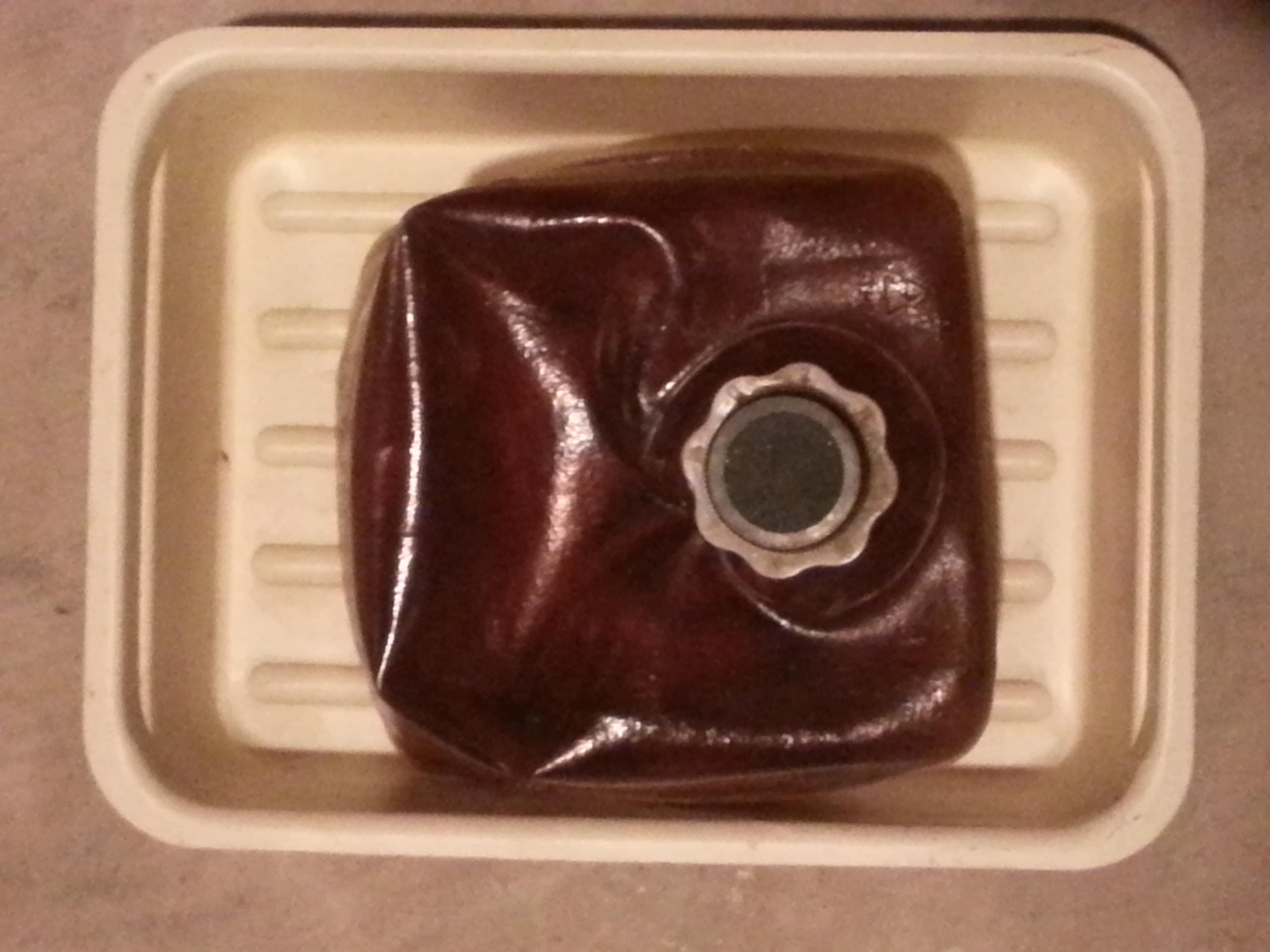

I have some old Ektaflo (1 gallon size) concentrate (about 90% full) in its original clear plastic container. It works fine and I'm happy with it.
The problem is that, at the cap there has always been some leak (or sippage). Then it is very hard to open the cap with the solid from the leak.
I'm thinking of moving the concentrate to another bottle, probably the 1 gallon Falcon accordion. Do you think this is a good solution?
Thx.

When I got this item, it was in its original box. But it was leaking and the solid residue "froze" the cap. It took me quite some time to unfreeze the cap. I put the entire container in a water bath.
Right now, I try to keep the cap at the top and try not to let the concentrate to get to the cap. This time it was not too bad to open the container.
I just wonder why the later T-max concentrate does not use the same container, but the regular silver 1 gallon bottle.

I acquired some Ektaflo Type 1 paper developer some time ago, of unknown age. It is an unopened cubitainer. I wonder if it is the same as yours and how well it held up. I've not gotten around to trying it yet.

I have been using this old stock for 2 years, no problem.
This is a pic of the container. You can find the similar package at wine store for Rose wine :smile:
