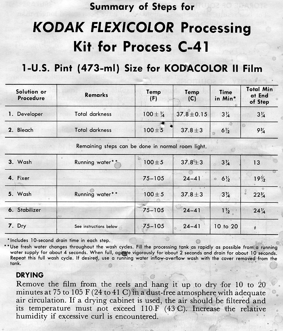

My washing technique is to put the tank under the faucet for 3:15 dumping every 30s-1m. Is it worth letting it soak a bit to get more of the bleach/fix residue out? I always noticed that when I washed Tri-X more of the purplish dye in the film base would come out if I soaked in water for 15 minutes with one change of water after washing but before using Photo-Flo.
Any other advice on how to know if developer is still good. Does the stuff generally last a month if mixed with distilled water and stored in glass?

C41 process cycle
Here is the Kodak official process cycle.
If this leaves the stabilizer pink, then the final wash step is not adequate.
PE
