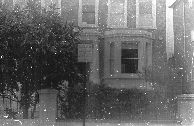

GJ-1
Red Grape Juice pH 3.7....................600ml
Sodium Hydroxide...............................3g
Phenidone.........................................0.2g
pH =10.9
HP5 at EI=200 was developed in GJ-1 60min 20C, ag 10s every 2min.
The negatives were underdeveloped but printable.
One negative was bleached in 100g/L ferricyanide+bromide and fixed.
A very faint relief image caused by the tanning of the gelatin by Anthocyanin or derivatives is shown in the attachment.(It is possible to provide a much better image from unbleached negative).
Anthocyanins are present at low concentration and may be hydrolysed but produce detectable tanning.
Other red/purple berries contain Anthocyanins, as a curiosity it may be possible to make staining developers from them.
Thanks for comment.
