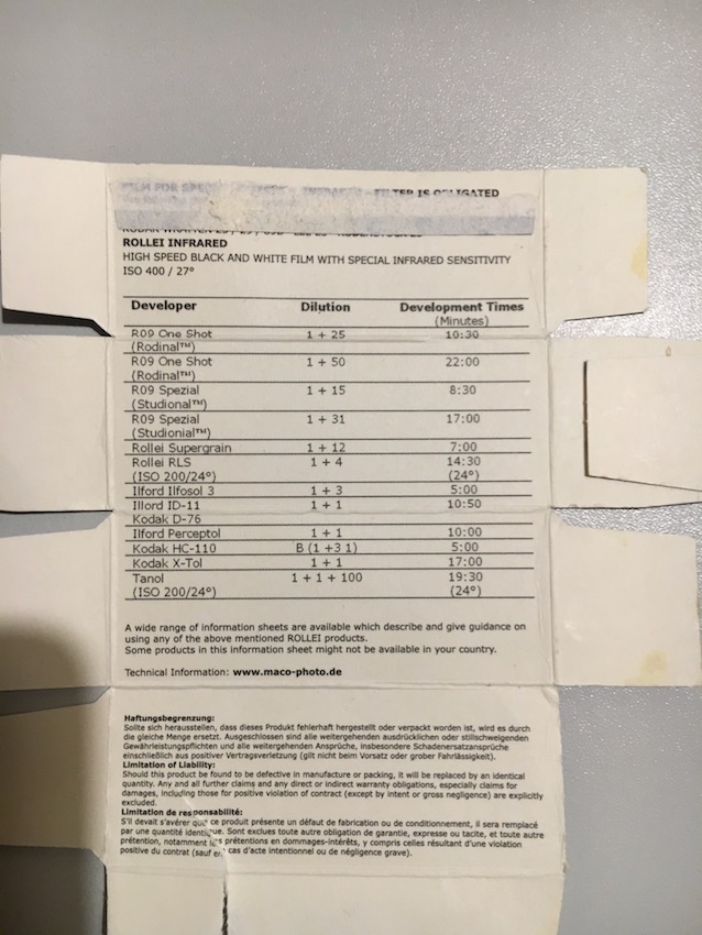

I used Xtol 1+1 when I developed this film last year and I was pleased with the results. Developing times are on the inside of the box. Note: these times are different from those in Massive Dev Chart. I used the box times with no problems. ID11 is another option (see photo).

Thanks - my roll was sold to me without a box so was devoid of instructions!
