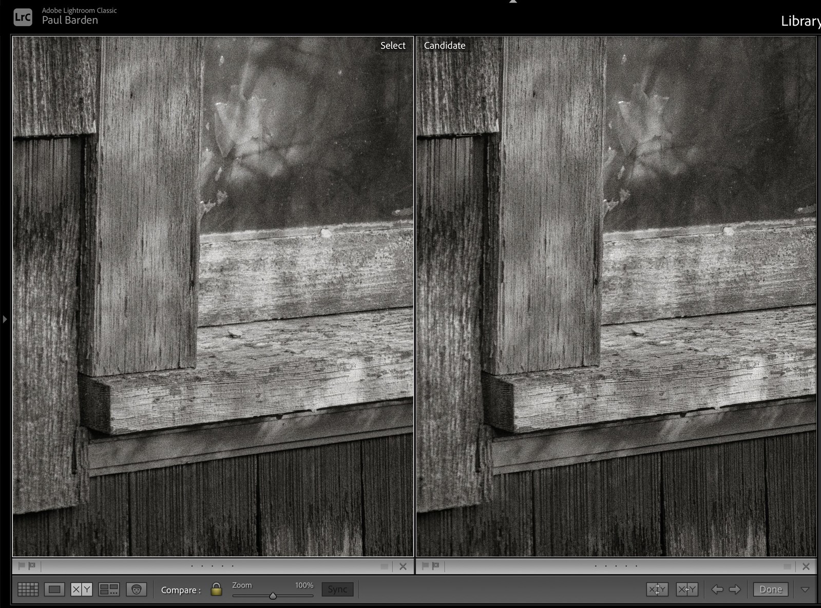

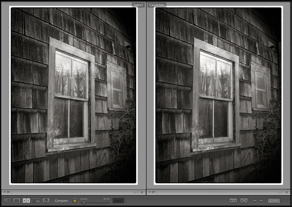

Recently there have been some discussions about various developers and how they act on films, and I thought I'd share an experiment I did back in January. I wanted to compare a "high acutance, compensating" developer with a very simple "average acutance, soft acting" developer to see for myself just how different the two could be.
I exposed four 5x7 sheets of Ilford Delta 100: two exposed at 64 ASA and two exposed with another half stop exposure, just so I had a choice between two exposure variations, for optimal results. One sheet of each exposure was developed in D-23 diluted 1:3 and one sheet of each exposure was developed in PMK (Pyro) at 1:2:100. The lens I used was the f7.7 Kodak Ektar 203mm.
I chose the 1:3 dilution of D-23 because literature I looked at suggested it becomes more of an acutance developer at high dilution, due to the reduced amount of sulfite in the highly diluted solution. Of course, development times become a bit long, but I found 15.5 minutes @ 70F to be acceptable. I used PMK at the standard dilution and time for Delta 100, which was 13 minutes at 1:2:100, @ 70F.
The D-23 negatives and the PMK negatives came out looking remarkably similar, aside from the PMK stain. When scanned, there was only a very small difference in the tonal scale of the PMK negs VS the D-23 negs, and in processing the images in Lightroom, I had to make only minor adjustments of the high values to result in a similar tonal range for each negative. The overall density of the negatives and the available shadow information was very similar for both negatives - they varied only in the highlight density, and that was a minute difference.
I'm guessing you'd like to know how the two developers compared as far as acutance and grain is concerned. PMK is known as an acutance developer with some compensating ability, preserving the fine details and definition of the high values while also masking grain somewhat, thanks to the Pyro stain. D-23 on the other hand - and this is why I chose it to make the comparison - is known as a "soft-acting" developer with low-to-average acutance and average (but sometimes mushy) grain. However, the negative developed in D-23 diluted 1:3 was remarkably similar to the PMK negative: very good acutance, excellent preservation of the subtle high values and crisp grain characteristics. I had difficulty seeing any significant differences in the resulting images from the two developers. There was, however, slightly better preservation of the very highest white values in the PMK negative, as expected. But the highlight information in the D-23 negative could easily have been preserved in print.
Here are some A/B comparisons of the PMK neg and the D-23 neg, at full size, and a crop at 100% to show fine detail. (The scans are uncompressed TIF files, at approximately 6000 x 8000 pixels).
The PMK images are on the left and the D-23 images are on the right.
Because these are screen captures, they don't show the resolution the full images have, so if you want to see the images at full size, the PMK image can be viewed here, and the D-23 image here. (To view at full size on Flickr, click twice to zoom)

Thank you for doing that comparison.
I think I prefer the D23 slightly over the PMK, which is a surprise.
Me, too. The D23 image looks smooth in a nice way, PMK makes it look "over sharpened"...
PMK can have that look sometimes, yes - especially if you are using a sharp lens at its optimal aperture and a sharp, low speed film known for its acutance. Pyrocat HD is even more intense, so I use it sparingly and only for some situations.
But ain't it good to know that D-23 is versatile enough that you can turn it into a high acutance developer by increasing the dilution?! It's not exactly the "soft cousin of D-76".

Me too. It has a tonality that is less exaggerated than the PMK image. But its all a matter of taste - neither one is "wrong".
Thank you for taking the time to share. That was interesting.
You're welcome. Glad you found it interesting.

Interestingly, I would say I can get a similar look using Pyrocat (the Windisch variant without Metol etc.) with FP4+, TX or TMX using my Rolleiflex with uncoated 4.5/7.5cm Tessar.
But those are too many variables to make a general point.
Anyway D23 is a candidate for my future 13x18cm (uncoated Protar VII) / FP4+ / Lupex G3 contact printing dream...

Thanks for posting this @retina_restoration ; for me, this proves one more that the strong preference we may have for certain developers should be seen in the light of the often marginal differences they have in a real-world application.
More importantly - that's another particularly successful photo, very true to the distinctive/characteristic style you have developed. A pleasure to view. I quite like how you used the edge of the image circle as an integral part of the composition; I would have never thought of doing that, and it works so well here!

Fantastic comparison, thanks for sharing. And beautiful photo.
If you had the time to do a D23 1:3 vs D76 1:3 or XT3/XTOL 1:3 as above I think many people would be interested in your results, too!

That's what I took from the exercise also. It seems to me that people sometimes attribute properties to a developer that are more imagined than real. We tend to see what we want to see - it's part of being human.
I'm not suggesting that D-23 isn't a "soft-acting" developer when used as a stock solution or low dilution, because I have done testing of it, comparing it to Pyrocat HD, and it does give a softer look: fine grained, but lacking in the "hyperacutance" of Pyrocat HD. However, it's useful to know that a simple developer like D-23 can serve as an acutance developer simply by diluting it more. Knowing what your chemistry can and cannot do is a valuable and important component of your darkroom tool kit, IMO.
More often than not, the simple tools you already have at your disposal are all you need. The "magic" is in learning what they can do for you.

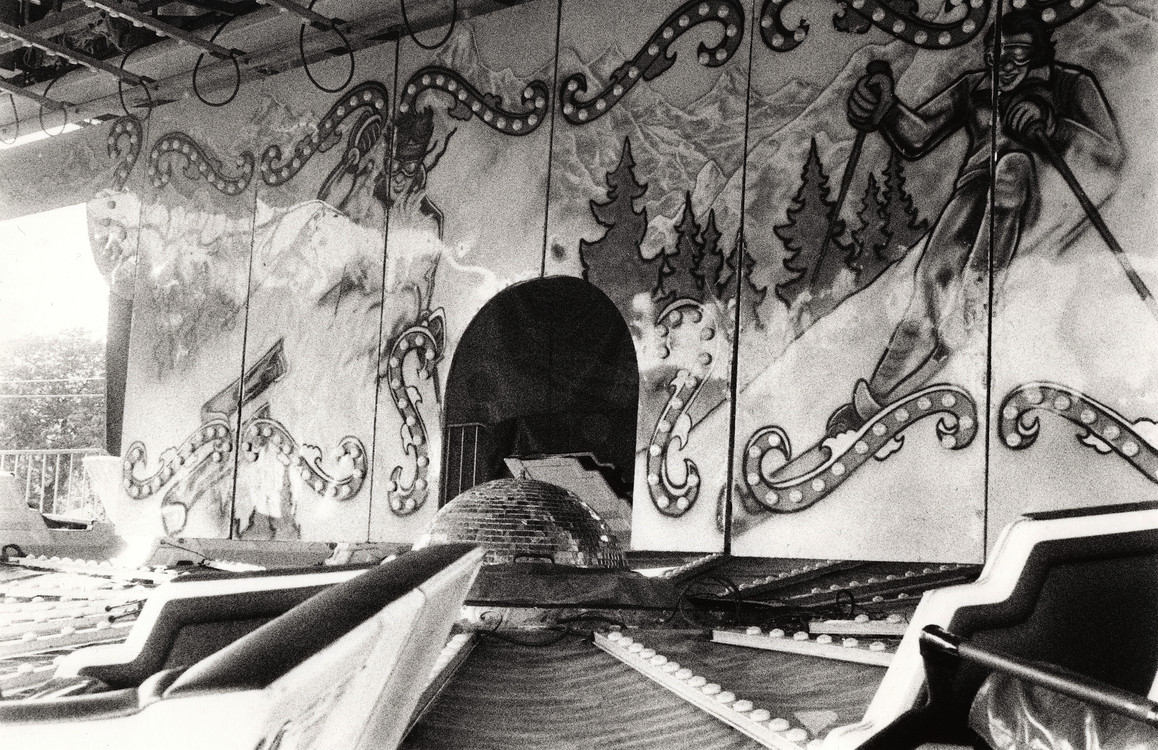

Upon your recommendation a while back, I tried just this. I used D-23 1+9+0.5g/l Sodium Hydroxide and got razor sharp negatives.
I would not use it for 35mm, however, because it gave me pronounced grain beyond what I like. This is a scan of a workbook print from a 35mm Double-X negative semistand processed in the above developer for 60 min. I am certain it was developed for far too long and hence the left side is far too bright (though there is still detail in the negative, had I bothered). Reducing that time would decrease the grain somewhat, but the hyper-acuity really pops the grain:

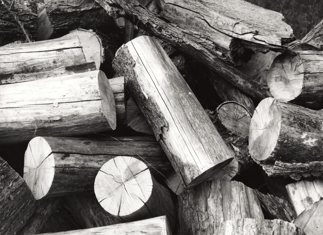

Here is the same thing with Fomapan 100 9x12:
