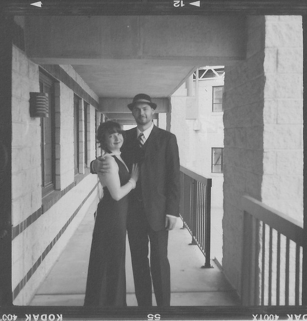

After all that I am pround to say that indeed images have appeared on my film! I have acheived some level of success! Hmm, I'm working at setting up my darkroom but it's not ready yet. So how am i going to view these things so I can see how i actually did. Sure I can take them to the local camera shop and have them scanned but where's the fun in that? Let's see, my D70s with the slide duplicator? No, the negs aren't going to come close to fitting, no surprise there. Let me lay them on this white paper and take a picture of the negative and i'll see how it turns out. Not too bad. Not perfect but not bad either. What else? Since laying them on the paper seemed to work for a photo, I wonder how well they'd scan if i just put them on the glass of my flatbed scanner and scanned them? I don't have any film adapters for them but what have i got to lose? I was surprised at the scanning results.
Test20001 by jmsnoopy650, on Flickr
Test20001edit by jmsnoopy650, on Flickr
After inverting and using convert to black and white under the ehance button.

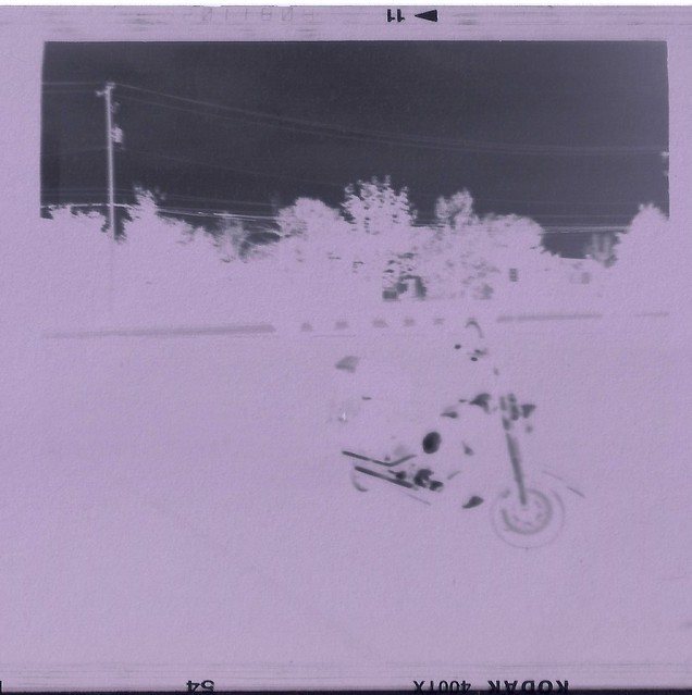

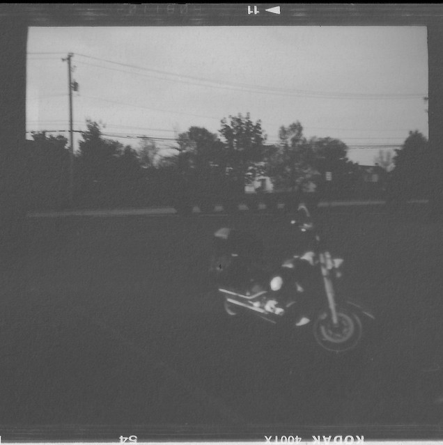

Test20002 by jmsnoopy650, on Flickr
Test20002edit by jmsnoopy650, on Flickr
I think my exposure and focus was off on this one.

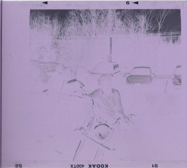

test40001 by jmsnoopy650, on Flickr
test40001edit by jmsnoopy650, on Flickr
Not sure if these were my exposure or developing. Opinions?

Work on your metering technique. Your negatives are underexposed. If you expose more, you may need to shorten your developing time a little bit, to avoid blocked up highlights.

- you should expose your film more, probably one more stop on the first frame and about 2 or 3 more stops on the latter ones. The shadows are lacking detail.
- you're maybe over-developing a little. This is usually due to poor temperature control (you should be well within 1C); you can adjust your development time if you're sure your temperature is right and consistent. This depends on how you intend to print and the lighting conditions you're in, so don't change your time just yet, just do a few more rolls and be very careful of temperature.
- when inverting B&W scans, set the black-point no lower than the border density, i.e. the border of the negative should be completely black not dull grey. Otherwise your image itself will have no blacks.
