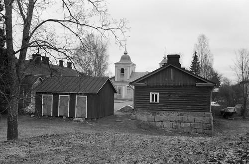

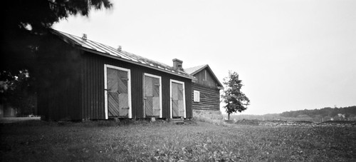

Don't dismiss your environment as being mundane, when I was in Finland people I knew were always intrigued why I was interested in the mundane things there.
For instance
this locale:
from a different angle with a pinhole camera
