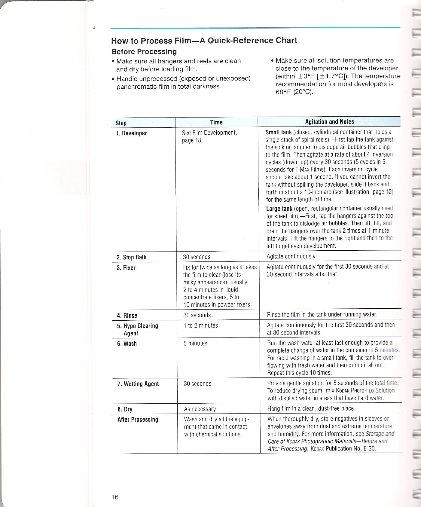

You don't say which fixer was used, and how fresh, and for how long you fixed. TMax film normally takes 2-3 times longer to fix than traditional film, regardless of fixer type.

I use EcoPro Neutral, and it will clear film in 30 seconds, but it takes a full 6 minutes to fix TMax. I think you need to re fix with fresh stock.
