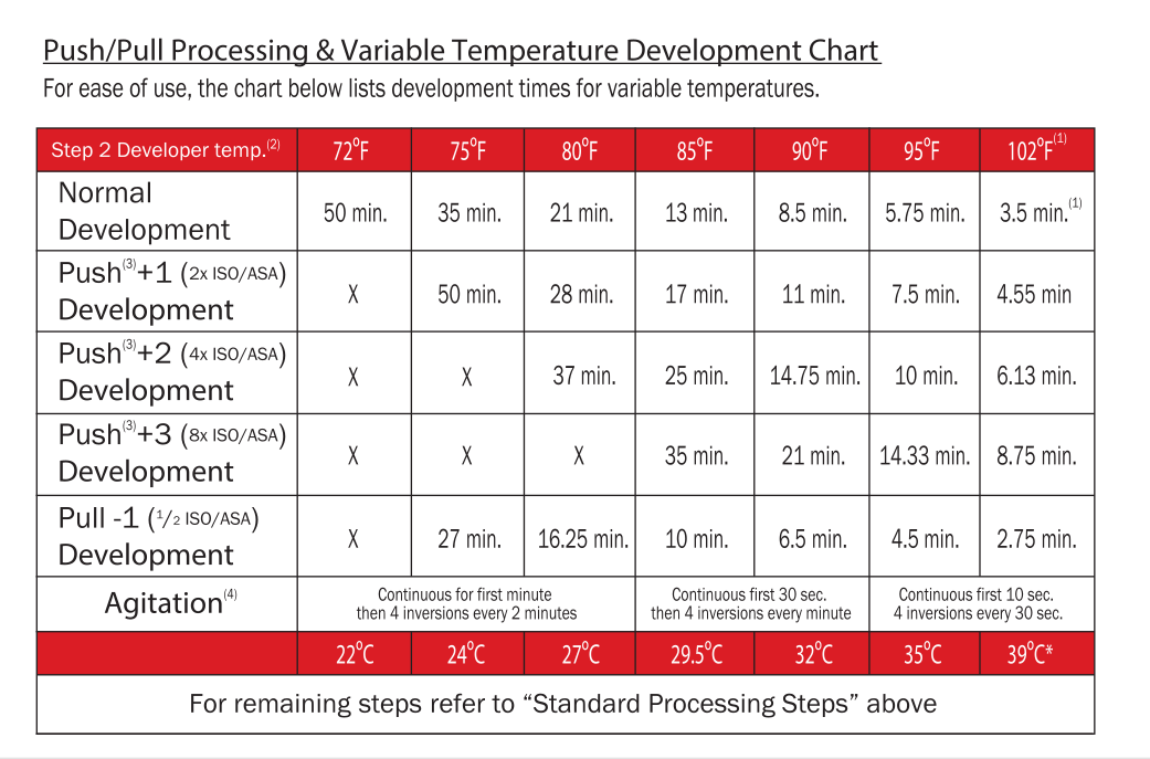

If you do not have a developer (CNS), and of course you will have to use the process (C41) as at least, you can develop these films according to the cold temperature.
CNS films are primarily designed for cold processes.
Therefore, I sincerely advise you to use the attached table, I have already relied on this table and the results were good.
