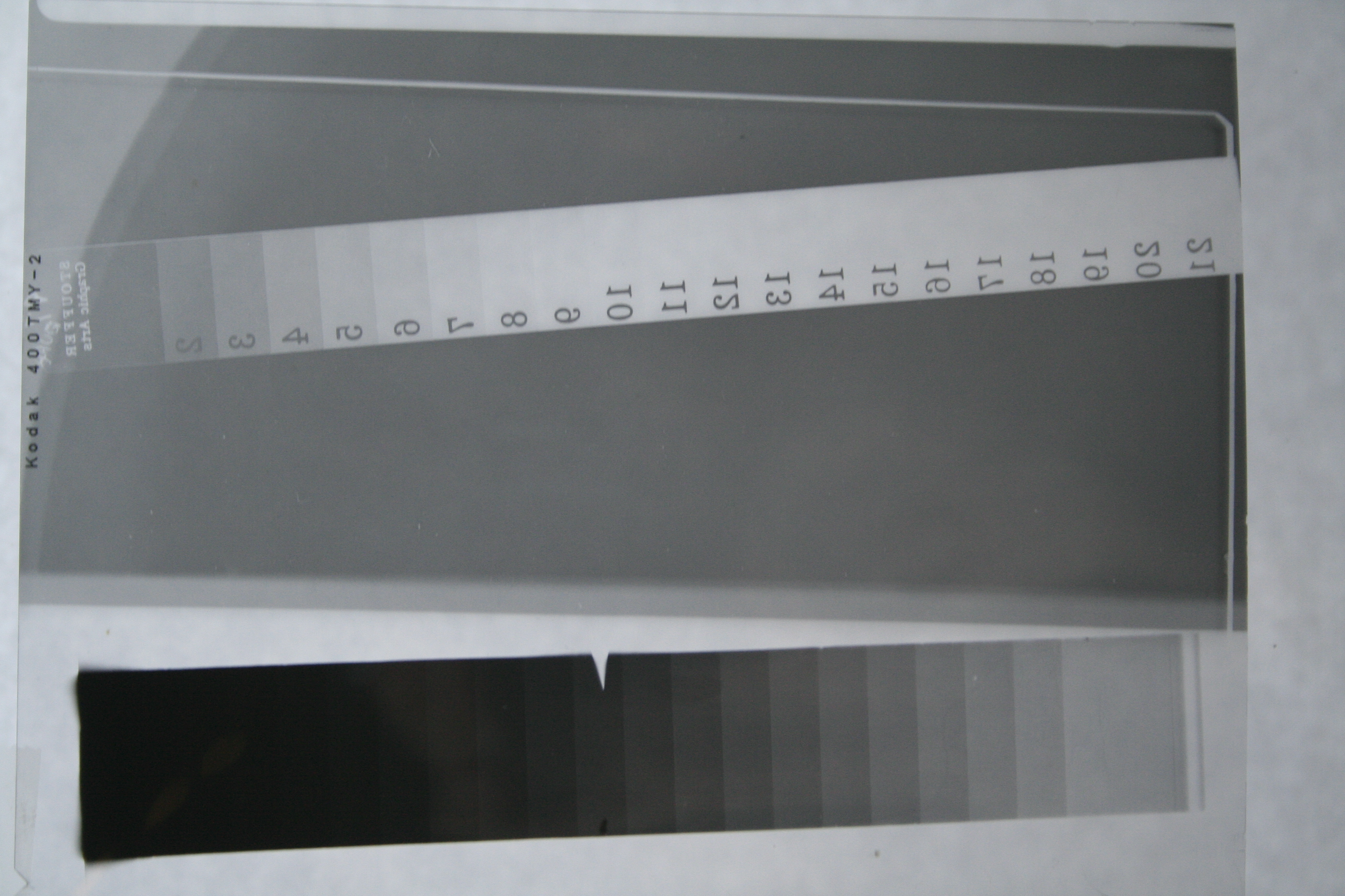

After testing an hour exposure, I decided to dim the light by the equivalent of “Step 4” (0.45 density)… using a piece of black and white developed film (it was a lousy 4x5 negative from a rodeo, the dirt was about the right density) to dim the deep red near infrared LED. My goal was to have TMY2 have barely any fog in 15 minutes (about what you see on “Step 8”).
The viewer needs an near infra red light to see anything, true infrared LED’s show as a detectable white dot on the viewer but don’t provide enough light to see anything.
I would practice on film to get used to how much development makes a negative with good contrast. It takes experience and judgment to truly develop by inspection. I don’t do that, except in a go-no go sense to make up for mistakes like serious accidental underexposure.
Though I use it regularly, I still develop to time and temperature. I use this as an aid to be less clumsy. Plus it’s as fun to watch a negative come up as it is to develop a print under regular amber safelight. It’s good fun.

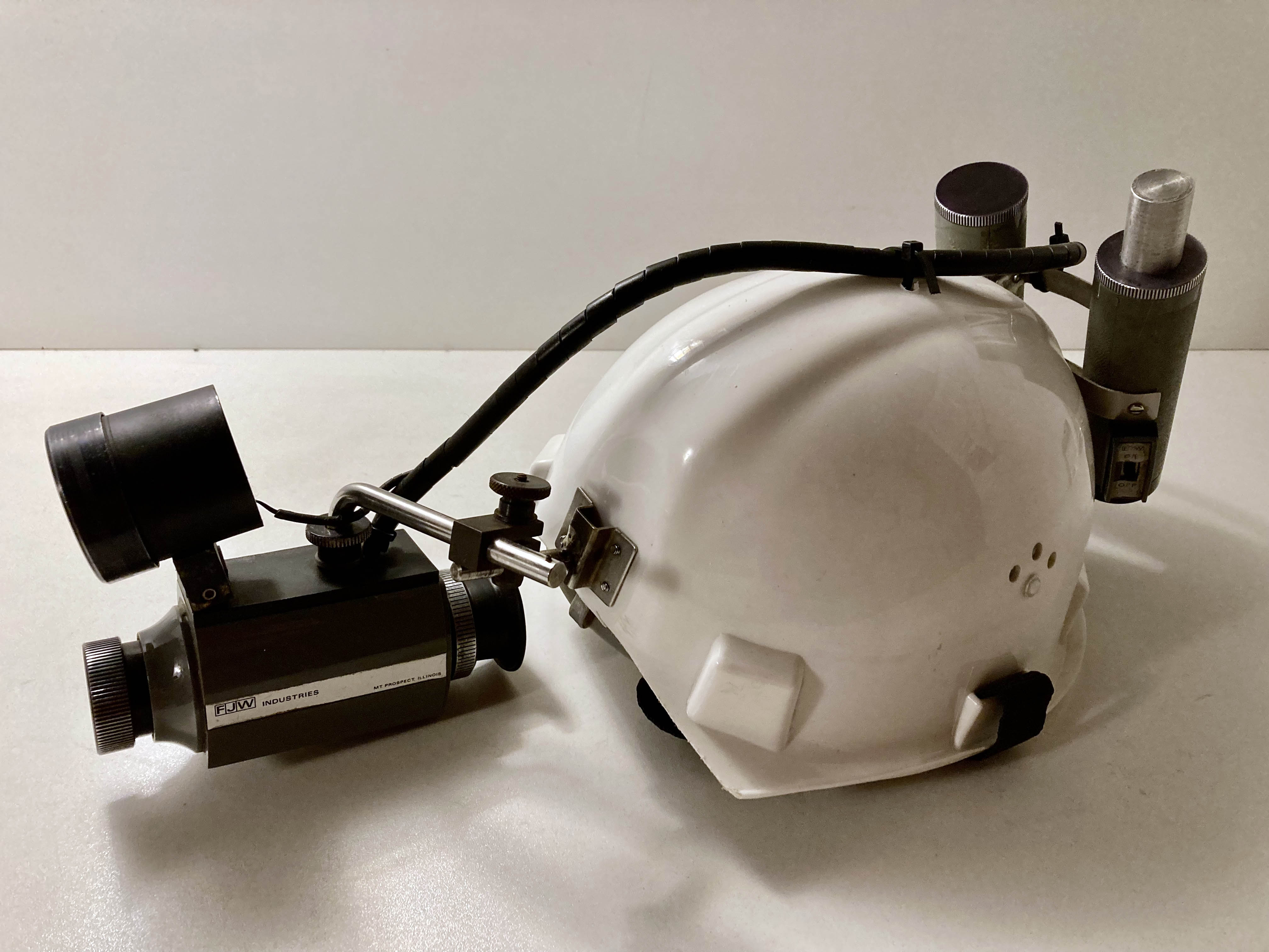

What I still use is this rather 'antique' device I bought used from the AGFA-GEVAERT Mortsel factory in the late '80s.
It was originally intended when working with the Colenta (colour processing).
I mounted the whole set on a construction yard safety helmet because of the two battery packs/power intensifier, one of which is for the very functional little IR headlight.
Those batteries keep the whole thing in balance on my head...
