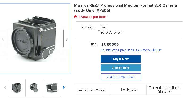

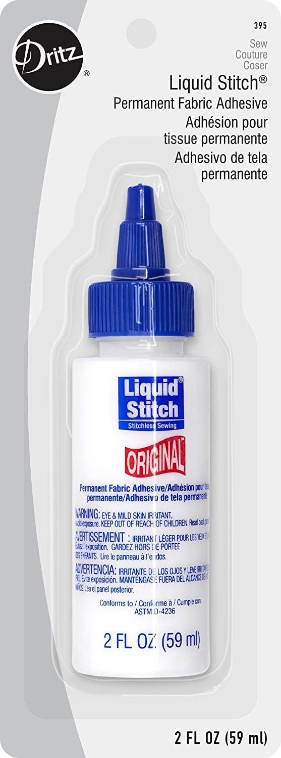

Try this to repair the bellows:
You may search ebay this: mamiya rb67 replacement bellows
$75 + shipping...
Or you may buy an additional body for around $99 , I'd do that...
Thanks.
There's no light leak on it, it just doesn't fold back onto itself where it should so it's blocking the mirror from moving freely.
