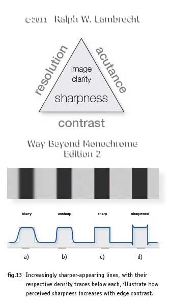

Let's start by defining sharpness (see attached). What we perceive as 'sharpness' is a combination of acutance, contrast and resolution. Optimize all three and you'll have the 'sharpest' image possible.
