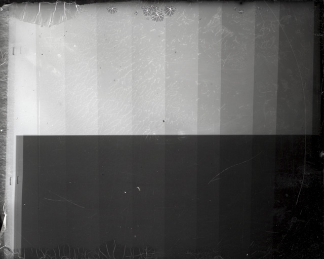

I made an attempt today to measure the ISO of Batch 2 -- my second emulsion mix after the batch I mixed back in the fall. It was sunny and pleasant day outside, I had the day off, and I could thus take advantage of the Sunny 16 rule. I also have a gray card (18% gray) and a white poster. I set those up in sunlight, so that the gray card and white poster each filled half the frame. I then exposed sections of the plate similar to what you do in a darkroom under the enlarger when determining the proper exposure for a good print.
Developing this plate, I evaluated the densities and determined this emulsion batch is running at about ISO 0.5. The deduction involved calculating EV based on the shutter time corresponding to best density, and then using the EV equations to back out S in EV(S) = EV(100) + log2(S/100). A couple of test shots indicate I might actually be close to the actual ISO rating.
So this method seemed to work. However, I'm not even going to get into how "...I evaluated the densities and determined...". Suffice to say it involved a scanner and leaning heavily on my image processing background as an optical engineer to remove the effect of the scanner itself (I assume "scanner" is not off-topic for this subject as it was used as a evaluation tool and not used as part of a photographic process per se). Very susceptible to GIGO.
Please feel free to point out issues with my method. I'd be curious to know how emulsion sensitivity was evaluated originally -- i.e. at the turn of the 20th century, before densitometers were available but yet they would have used the scientific method -- or at least a better method which is less reliant on suspect methods such as scanning and compensating for the gamma curve. Any reference texts I can review?
For reference, here is an example image from today's testing. The top half is the white sheet, and bottom is the gray scale card. f/# was set to f/45, and each strip is increasingly exposed in 1 second increments (1 second on far right, through to 11 seconds on the left).

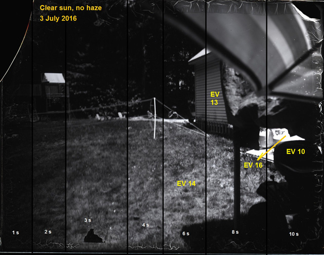

Here's a strip sample with associated exposure times. After all my talk about cutting holes in dark slides, I couldn't find the dang thing when I took this shot.
I've also included exposure times for each strip as well as EV readings at various regions of the scene.
Shot at f/16. Developed 1 minute in Dektol, 1:2 dilution, constant agitation, 74 degrees.
I selected the 6s strip as the most balanced, understanding that vegetation should be slightly darker.

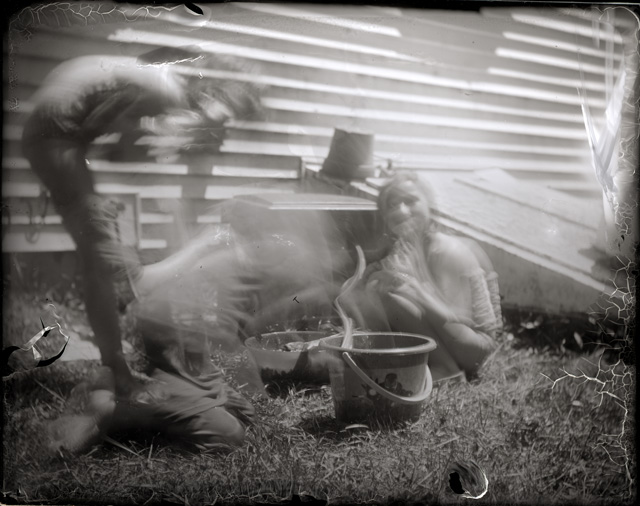

Here is proof that kids can't sit still for 3 seconds when they are busy with water balloons. 3 seconds at f/11 (overexposed .. should have been 1.5 second exposure):
After this we all piled in the car to get ice cream and drive around so I could take a couple of photos. However my wife started talking chores and upcoming itineraries for weekend activities and work -- which isn't very inspiring for doing any type of creative photography. She once said that marriage is finding that special someone that you can annoy for the rest of your life. We've both successfully done so! So it'll be tomorrow probably before I get to play again. I plan to set up down on main street for the Independence Day parade. That should be fun -- our fire department has fire trucks dating back to the 1920s which they usually bring out for the parade.
