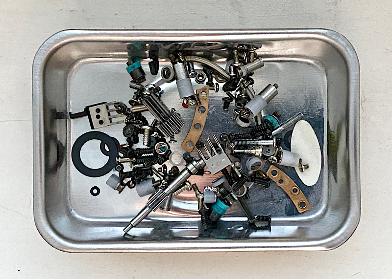

I have a collection of all kinds of screws and small mechanical parts from photo equipment that I have dismantled or that serve as a spare part supply.
In principle, it is not a bad idea to leave screws and parts in the original holder, as they can then be found quickly for repairs.
However, I would like to set up a filing system for the rest so that they can be stored in an orderly manner.
So how can I organize and identify screws and parts?

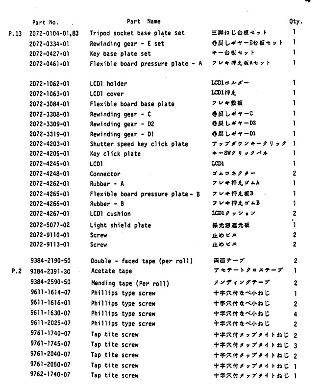

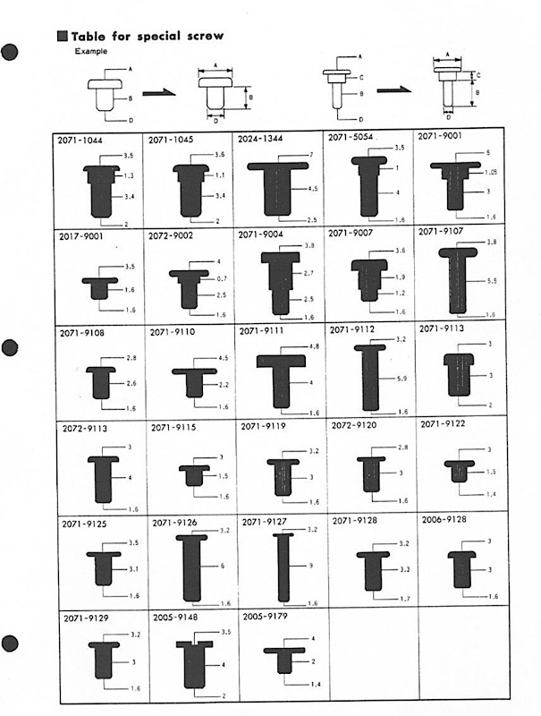

Here is a table of the screws used in the Minolta Maxxum 9000 AF. There are only codes for them, but no names. This makes communication difficult because otherwise you can only describe the screws as best as you can.
As far as the mechanical parts are concerned, I stick to the names in the service manuals.
Here from the one for the Minolta Maxxum 7000 AF. This is the original name given by the manufacturer and is therefore binding.
But a mechanical engineer might use more precise terms. These here are quite general.

In the example of post 10, I’ve noticed that they all tend to have part numbers and the same nomenclature: special screw. To distinguish better, reference to the part the screw is used for might be most useful. Like ā€œSpecial screw, number 123, for wind spool pawlā€, or ā€œShoulder screw, number 123 for wind spool pawlā€.
In that example, all pertinent dimensions are given. Doesn’t much matter what name is assigned other than to allow for a non-engineering name/description.
For storage… 35mm film canister and zip lock bags, marked with a Sharpie.
