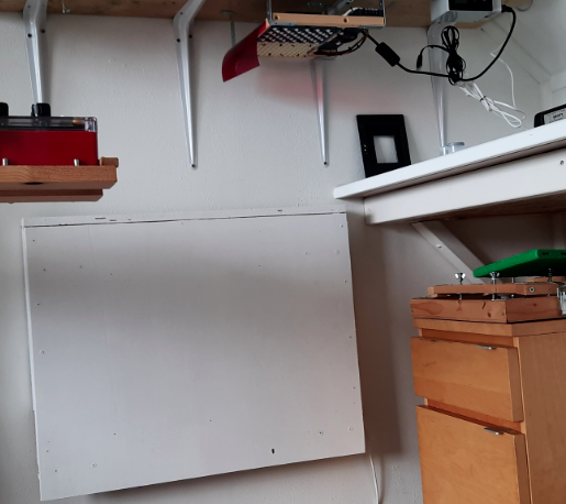

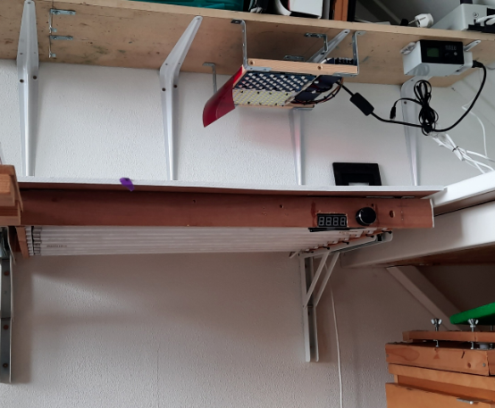

Alternatively, mount UV box over worktop. Can also be a flat assembly that folds against the wall so it's (mostly) out of the way when not used. E.g.:
Note the lower exposure unit consisting of a bank of UV tubes. This one folds down if not needed. The top side functions as an extension of the worktop to the right if I need the surface area.
Note also the tiny (test purpose) LED-based exposure unit mounted to the bottom of the shelf over the worktop.
Here's the tube bank folded against the wall:

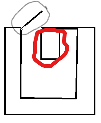

Can you put the sink in the middle of the room, in order to permit access from 3 sides?
I could do, but to what end? Why would I need to access the sink from 3 sides? Heck I can put it in the middle of the room and permit access from 4 sides, but that starts to compromise the compact goal!
It allows you very flexible access to the sink. If you then surround it with work areas on three walls, you can fit a lot of functionality in a small space.

Probably I'm being dense, but I'm still not getting why I'd need such flexibility? Aren't I always going to be doing dry work then wet? And if all enlargers/exposure devices are in the same place, it's the same trip every time?
Well, it seems to me that you won't be using the enlargers when you are doing the UV exposure based processes, so you will have at least two different workflows. Having access to the sink from both sides makes it easier to have the workflow dependent elements in their own locations - less having to move things around each time you go from silver gelatin to RA4 to cyanotype to etc.
There would be less value to doing this if you only worked with a single process.
Here is a really crude sketch - nothing is to any realistic sort of scale. The sink is circled in red, and the door in grey.
Gotcha. Having never done any of the alt processes, I'd better wrap my head a bit deeper around them in order to have a shot at thinking it through!
