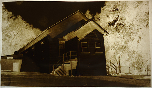

For example, with this calotype I made earlier this month:
Bennett Valley Grange Calotype par Ned, on ipernity
LV ranged from 11 in shadows under trees on the right up to 16 with sunshine reflecting off the white wall. I chose to base my exposure on LV 15, and exposed my calotype for 3.5 minutes at f/16. All this information might be useful for someone else working with the same calotype process: a "standard" exposure for LV15 at f/16 would have been 4 minutes, so this describes how much I backed off, and explains why the development went longer and how I ended up with more contrast and a denser negative. So the LV is important to be able to describe how the choice of exposure was made.
