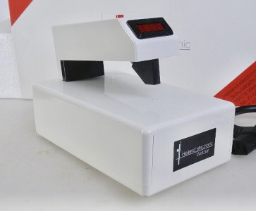

Old thread revival alert!
I just purchased ( from the classifieds ) what I assumed would be a current version of a Heiland TRD 2 densitometer.
Upon receiving it I find it is an older one and since I am getting this for academic reasons I am wondering just how old it is and if there might be a reason to return it and sit tight until a current one comes up for sale. My main concern is older components that might no longer be supported by Heiland and calibration issues over time as stated above if it is too old.
It was not exactly a bargain either so considering I paid the going rate for a good used current one I am a tad miffed it is older.
Thoughts?

Did you receive this unit including the original calibration strip? You could try to do a calibration check yourself first, the instructions are in the TRD2 user manual, downloadable from the Heiland web site.
The last sentence from the instructions is:
"The tolerance is ± 0.02 log. D. If greater variations are encountered, the TRD and the calibration strip should be sent to the manufacturer, or authorized service centre, since a new calibration is not possible without the necessary testing devices."
I don't have a Heiland densitometer myself, but I read through the manuals because I want to buy one myself early next year.
You can also mail Heiland in Germany with questions (see http://heilandelectronic.de/home/lang:en), my experience is they are very responsive.

It comes with the transmission and reflective calibration strip, seems to be pretty much on.
I am just trying to pin down a date it was made because again, I was under the impression it was the current version of the TRD 2 which it simply is not.
I paid a small fortune for it, more than some up to date models have gone for on eBay. I have a note in to both Heiland and Versalab.

The user manuals downloadable from the Heiland web site (for the new model) are dated 01.03.2012 so it's older than that.
Also note the following caution in the user manual:
Never use the measuring head to carry the instrument. Damages caused by disregarding this rule are not included by guarantee. The measuring arm is mounted to the base unit by a precise bearing.
The precise bearing is needed to exactly align the light source and the sensor. So when it is displaced you will get wrong readings which probably can't be compensated by a calibration (the arm must be re-aligned).
Personally I would never buy a used TRD2. It is a precision instrument and you have no guarantees the original owner handled it carefully.

Well the upshot of all this is that it is pristine and well cared for, all original packaging so it's a chance I had to take I guess.

I have the very same one. Had it since about '98. Never an issue.

Excellent, I appreciate the input.
I heard back from Jurgen Heiland today, he it was about 17-20 years old and said even though some parts are no longer around, they do have some of the major components and support it.
I guess I will just roll with it.
