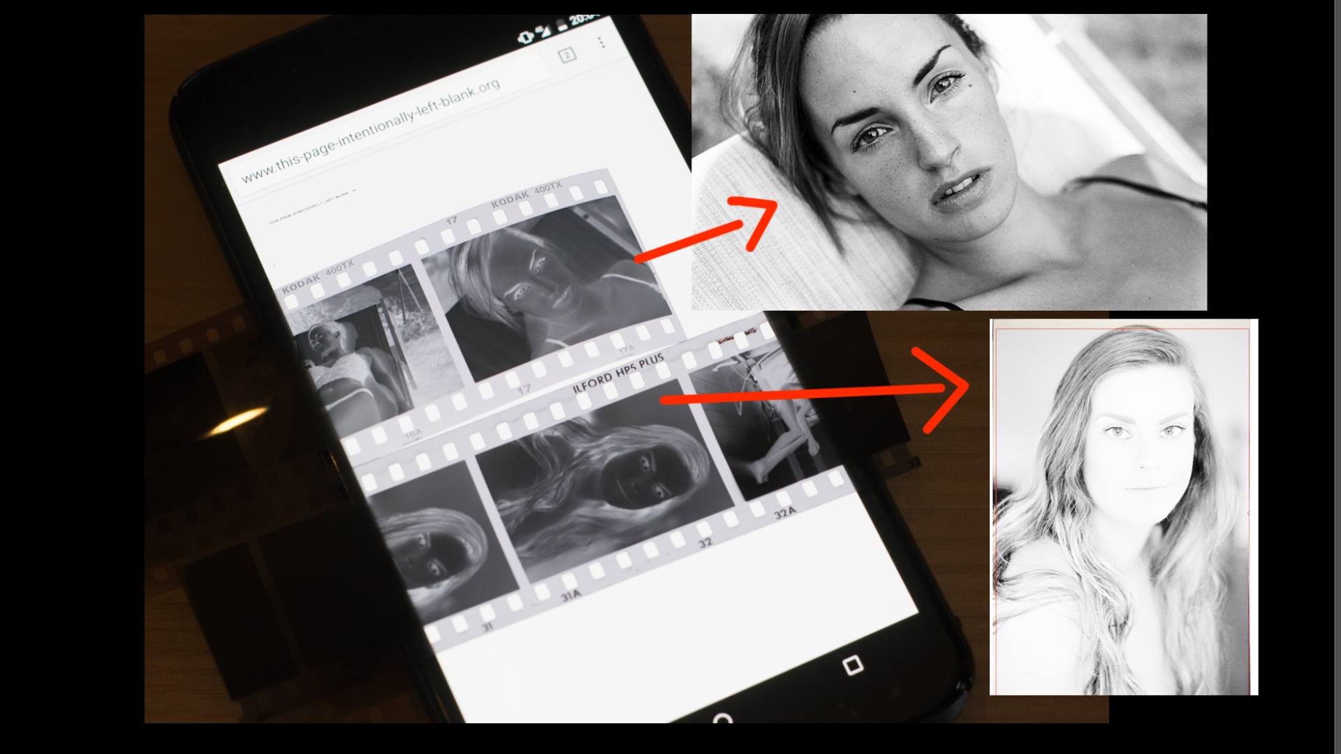

As the title said. Went out shooting yesterday. Developed 4 rolls of HP5+ in XTOL 1+1 at 20 degrees celcius. 120 rolls with a Rolleiflex MX-evs. They came out PERFECT.
However both rolls of 135 are way denser then my Rolleiflex shots? It was a model shoot, same building, same lightmeter, same developer tank... and yet such a difference. They are hard to scan (didn't have time for darkroom).
The 135 were both shot with a Nikon F3P. I recently switched from HC110 to XTOL.. so I'm really hoping that XTOL isn't the problem here. Cause other rolls with XTOL look fine, as were the Rolleiflex shots.
So I'm thinking that the shutter speeds aren't accurate from the F3P and overexpose the negative. But... I've found pictures taken with the F3P that doesn't have this problem as big as yesterday (Only have shot 5 rolls with the F3P so far - 2 of them yesterday).
So what could be the problem? I'm going to shoot with another Nikon body tomorrow, which has correct shutter speeds, develop the same in XTOL and see how they turn out. Let's say the shutter speeds from the F3P are correct too. What else could be the problem? That I develop for too long and that my Rolleiflex just in a miraculous way underexpose the neg - making better negs? Rollei has been serviced 2 months ago.. so I don't think it as a suspect.
I've been breaking my head around this - can't sleep from it.
Sidenote: I switched to XTOL because I lacked shadow detail and also had to print at grade 3-4-5 constantly with HC110.. I could have increased the time yes. But I wanted to try XTOL. My negs got denser and I was able to print at grade 2. But now they are too dense... And don't know which one to suspect. XTOL or Nikon F3P. XTOL seems odd since the Rolleiflex shots are okay ...
Update: Did a second roll with another body. Again dense negatives. So it's not a faulty shutter. Click here to read about the second roll. (there was a url link here which no longer exists)

I shot two rolls again. Cut 20cm of 1 rol to test with XTOL today. Used a DIFFERENT camera. SAME problem. So it's probably XTOL. OKAY if it's XTOL's fault.
But wait. If XTOL overdevelops my negatives, why are my Rolleiflex shots alright? If I put them side by side, 135 negs are much more dense than the 120 Rollei shots... Even with a different Nikon body (so it's not bad shutter speeds)!.
Edit: I took out a HC110 neg from the past, which printed well (could be that it was printed at grade 3-4 don't remember...)
See picture. You can clearly see the density of the neg is much darker of the XTOL thus overexposing everything. (Yes it's a different film stock but doesn't matter)
So is there such a difference between 135 and 120 emulsions? So that my 135 are overdeveloped and my 120 are developed perfectly? Or what else could there be wrong.

It's entirely possible, even fairly likely, that 135 and 120 emulsions are actually fairly different from each other. This is why I pointed out to you that the developing times are likely to be different. Given that you're running both formats in the same tank at the same time, the developer is not a problem because you're getting properly developed film on at least one format. The options left are:
1) The developing times for 135 and 120 need to be significantly different
2) Your personal EI for the 135 and 120 format HP5+ is going to be significantly different
3) Either your 135 camera is overexposing or your 120 camera is underexposing
I also mixed XTOL with tap water. Could that be a problem?
Yes, it could. However, many of us mix XTOL with tap water. As stated before, the fact that one of them is coming out properly developed and you're running them in the same tank at the same time, the developer MUST be fine.
