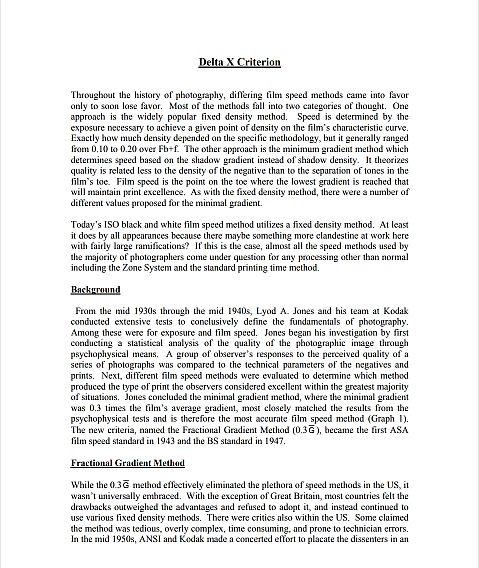

Can anyone attribute this article, for which I post an image of the first of 13 pages?

Stephen, thanks. I appreciated the paper, and thought I might find some related writings by discovering the author. Do such exist, on related topics? My interest is somewhat general - trying to understand the basics.
I hope that it wasn't improper for me to display an image of the first page.

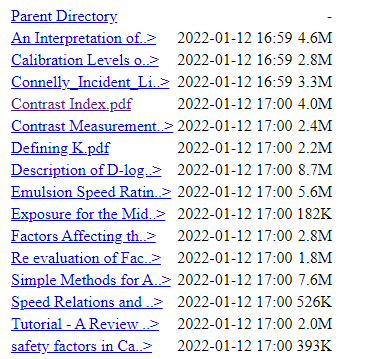

My site was down for a while but I found a new hosting provider. So try this link…

Sorry to revive an old thread, I can't seem to find the original article (Delta X Criterion) anywhere online. @Stephen Benskin do you happen to have a link?
Also, I just read What Is Normal and found it very helpful for a sensitometry beginner. Thanks for the demystification.
Jan 7, 2005
2,725
Los Angeles
  • Delta X Criterion.pdf
