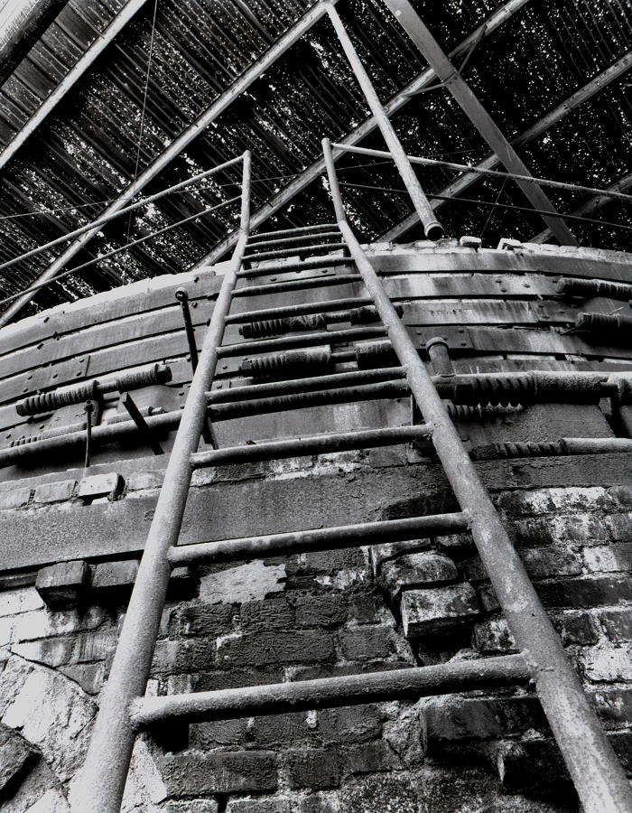

Thank you all for your help---If you care here is the story and outcome. My girlfriend and I got an opportunity to shoot in an old factory. The GF wanted to shoot MF so I let her use my Mamiya 645-1000s and 645e. She loaded one with 100 and the other with 400 (it can be very dark in the factory 400 is very nice at times), she also wanted to hand meter everything. Well she forgot to adjust the ISO when she changed cameras sometimes, others she did. Well after a talk we decided we really didn't know which rolls had be miss shot if it was a whole roll, she did change the meter every once in a while. SO we developed 100@100 and 400@400. You know you can tell the 400 frames shot at 100, they are thin and flat, BUT I think they are still very printable---a little grade 4 or 5 should to the trick . We just chalked it up as a learning experience, knowing her she will never make this mistake again, and she loves the MF and wants to buy it from me, which is nice because I want to sell it. Here is a pic scanned with the contrast levels brought up in NX2 I feel we could do better in the darkroom, and will use it as a teaching experience, she says she is looking forward to it!!!
