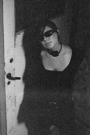

A little tip. I shoot @ 25000 with this film sometimes. My camera goes to 6400 and then I set exposure correction to underexpose by 2 stops. This gives me 25000
Of course... But, what kind of results do you get with 25000??? Thats amazing... I'd love try that...

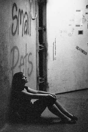

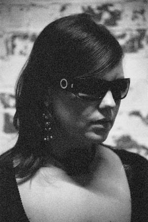

I have attached 3 neg scans from a film done @ 25000.
Morten

I used HC-110 for this as Rodinal is giving up with I hit 3200 with this film.
I underexposed heavily to be able to handhold the camera during the shoot. I definitely blow highlights and get detail-less shadows. But I like this low-fi grain-filled stuff.
