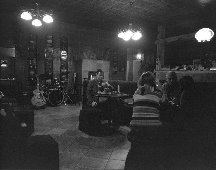

So, I did the shooting on friday and today I developed first of the 2 rolls shot (it was a bit of a test). I shot the Ilford Delta 3200 at around EI3200 (the light was terribly low) and developed in Tetenal Ultrafin liquid 1+10 for 19minutes at 20°C. The agitation was as follows:
* first 5 minutes continuous agitation: 1 inversion lasting 5sec, then 5sec wait, then repeat
* let it stand for the remaining 14 minutes with 1 inversion at the 10th minute.
I'm personally rather pleased with the results (see the attachment - a straight unmodified scan, I did not even change the curves/levels). For the second roll I'd let it stand for a bit longer, something like 21-22 minutes total...
Jiri
