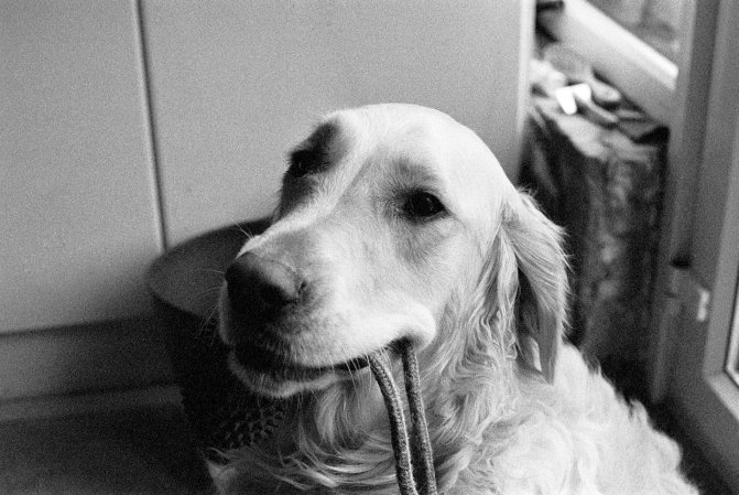

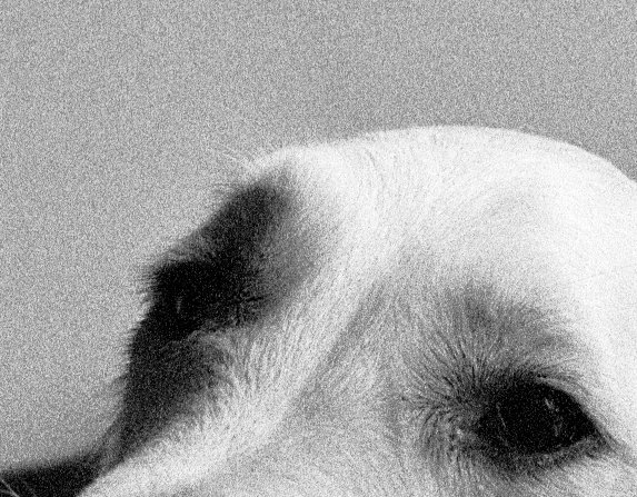

I find Pyrocat-HD and Delta 3200 a good combo at ei 1600 - an example attached with an example of the grain. What I find is that careful metering makes a lot of difference.
Times were 23 mins at 21 degrees C - constant agitation for first minute then 2 inversions every three minutes
Paul

thanks guys...
i seem to be doing ok with EIs a little faster than the "real" speeds with my other films, so i guess 1250 or 1600 is a good place to start.
thanks for the example pix too. the grain is interesting... very different from acros or hp5, but quite tight. well, will find some time to shoot a roll or two and see.
