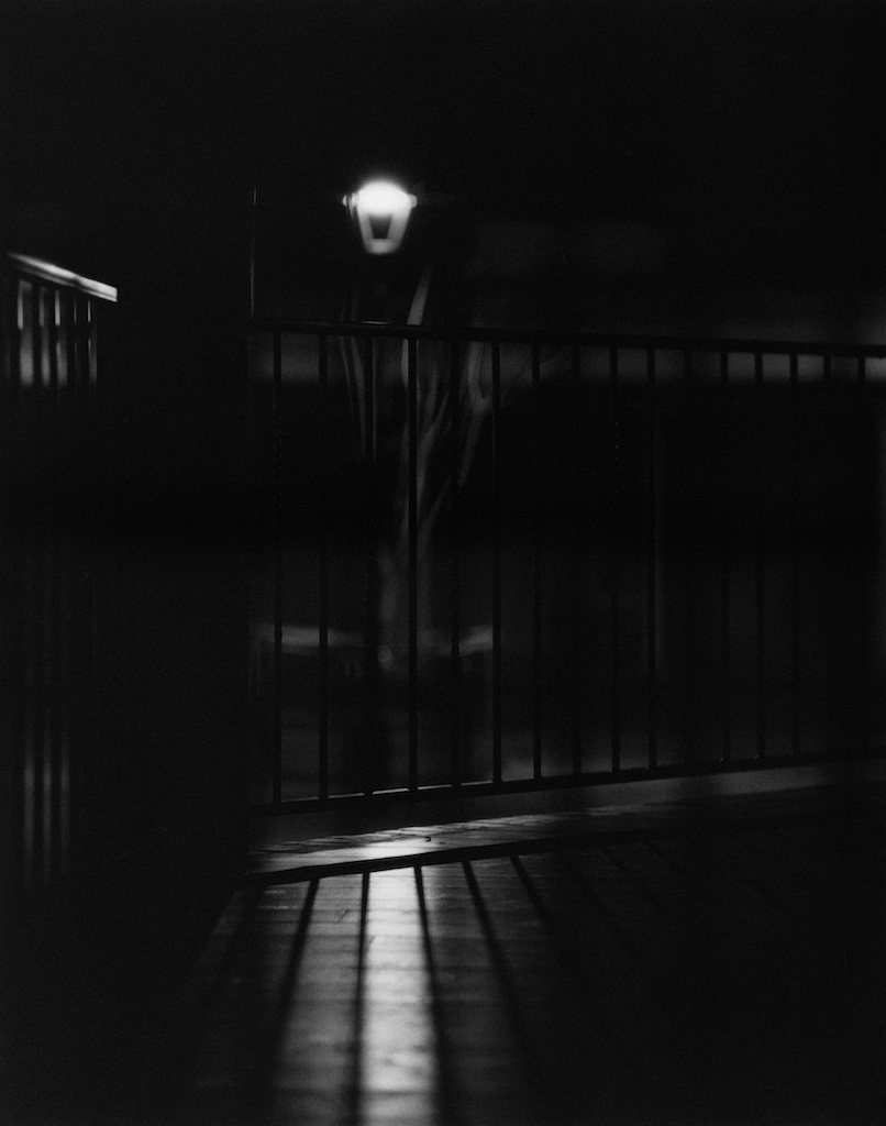

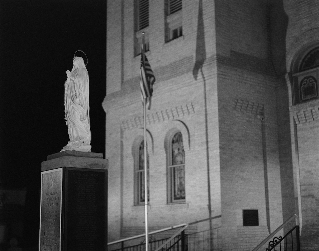

abruzzi
Mar 10, 2018
2,966
New Mexico, USA
here are a couple shots developed in Xtol 1:2 for 20 min @ 24C. They're not really EI3200, though the first probably was, rather they were shot wide open (ƒ2.4 for the first and ƒ2.8 for the second) at 1/30 handheld late at night. The second was probably closer to EI6400. These were shot on a Pentax 67:
M-88
May 2, 2018
1,023
Georgia
Thank you. I was surprised with smoothness of the results before I read "Pentax 67". Grain would probably be all over the place if it were 35 mm.
