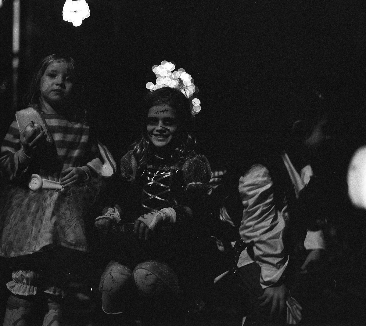

Hi everyone. I recently tried shooting Delta 3200 and developing with Perceptol. I initially tried the recommended 18 minutes at 68' (stock solution), and then after my negatives turning out WAY too thin I tried 23 minutes on another roll, still yielding terrible results. Does anyone else have any experience with this combo? Can anyone recommend a better solution for shooting 3200 ASA? Thanks!
Pic related - it's about how under-developed both rolls appear to be.

Looks like 1 or 1 1/2 stop lacking exposure for the recommended development.
I might have to check my RB67's meter against another then. I hope it's not been giving me wonky readings in low light!

Doesn't perceptol belong to the group of developers which lower iso of a film? I guess so, that would explain 1-1&1/2 underexposure effect.. Roger Hicks used to expose his HP5+ to 250.. I'd do same with Delta 3200 (which true iso is at around 1200-1600 anyways)..

Perceptol and high speed films are not sensible combinations.
Yeah. I was hoping that I could get the best of both worlds but sadly that didn't happen. I'll invest in some DD-X and try again later. Thanks!

Perceptol (Ultra Fine Grain) developer is usefull on a slower speed film and then in a 35mm format to suppress the grain. You will loose one F stop in iso rate too.
So for D3200 take above advice:
Microphen stock, HC-110 1+15 or DD-X 1+4
or Xtol stock. These are all speed enhancing developers.
Good choice! DD-X will be a much better developer for Delta 3200. Xtol is less expensive and a developer that is equally well suited for the job. Kodak TMax developers are very similar to DD-X, and they would do an excellent job as well.
