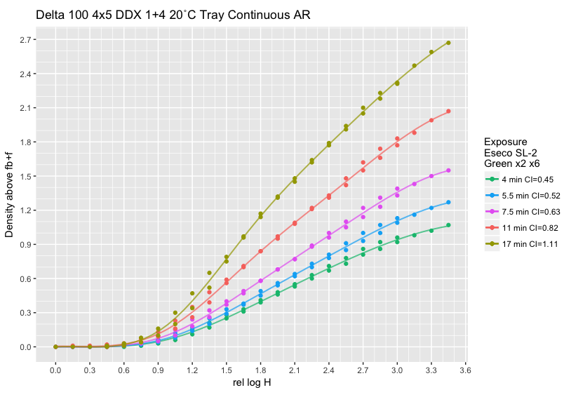

Following on from my 2012-2013 film tests of Delta 100 using the CombiPlan tank, I would like to share my newest results for which I have developed the film using the manual agitation method in metal trays, which I have learned from Alan Ross. I like this method, because it allows me to do 10–12 sheets at a time, and I can mix different dev times in one batch. It is also much less hassle than I expected, and I do not mind working in total darkness.

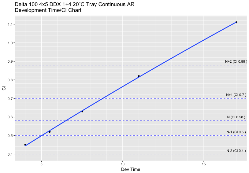

At 68F/20C using 4x5" Delta 100 and Ilford Ilfotec DDX 1+4 I have found the following times to be appropriate for my workflow: N=6.5 min, N-1=5 min, N+1=9 min, N+2=12.5 min. I still rate the film at EI 100, but I am going to retest that at some stage, although I feel I know this film well now, as I have been using it 99% of the time for some 5 years. These times are about 1 min shorter than the intermittent agitation times I calculated in the past, which a few of you seemed to have concurred with. However, they are still miles off the "official" dev time of 12 min suggested by Ilford and Massive Dev Chart—12 min is almost N+2 in my experience...
I attach the HD curves for this test and the development time chart, as well as the PDF showing the procedure (also available here as HTML) and the code in R that you can run on your own if you would like to plug your data into it (everything is free, including R). For that reason, I have also uploaded all the code to GitHub, including my sample data, and a walk-through in the form of an R Markdown document. These plots have been generated by this code for this film test:
I have already thanked a few of you, in the code and online, but once again, many thanks to @Bill Burk @ic-racer @dpgoldenberg @Rudeofus and @Stephen Benskin for assistance, not to mention @RalphLambrecht whose "Way Beyond Monochrome" 2nd ed inspired it a few years ago. If anyone wishes to amend my script, you are very welcome to do that on GitHub, just fork me and PR.
