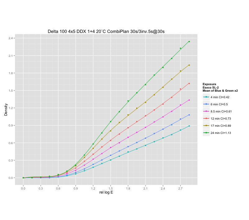

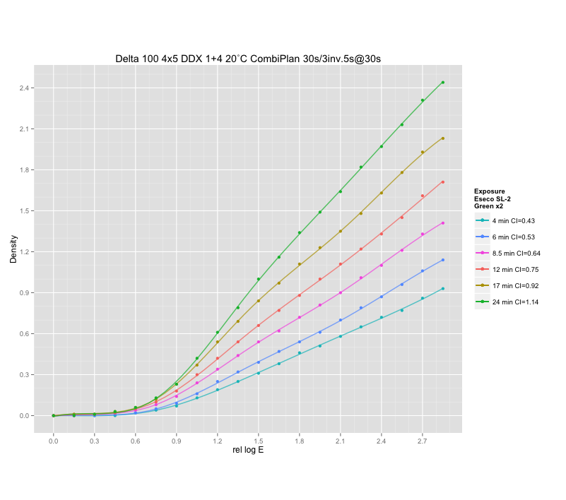

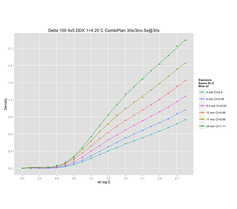

I have compiled, for you, three sets of charts (using my new curve/CI calculator, (there was a url link here which no longer exists) if you want to use it). One for just the green exposure (seems touch more contrasty), one for the blue (slightly softer), and then a third one, being a simple mean of the two. It seems my N dev time needs to be a bit shorter than Ilford recommendation (8 min vs. 12), which does not surprise me too much, as I aim for a slightly softer negative (CI about 0.58 as opposed to a more common 0.62, worth about a minute) and I tend to agitate more than typically demanded. I will be using the results of my tests for my next batch of real negatives, but I wonder if the curves look at all reasonable to anyone who has experienced this film in this developer.
Curves:
Delta 100 4x5 DDX 1+4 4-24 min Mean Green:Blue.png Delta 100 4x5 DDX 1+4 4-24 min Green.png Delta 100 4x5 DDX 1+4 4-24 min Blue.png

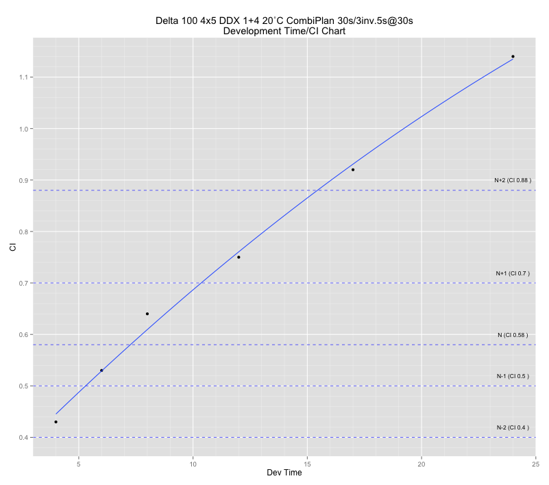

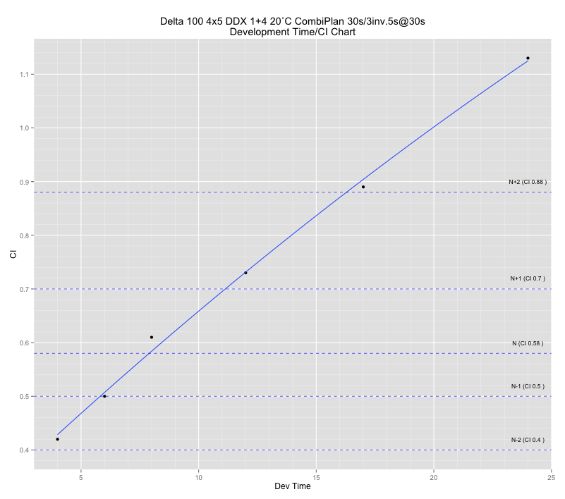

Development Time vs CI/N:
Delta 100 4x5 DDX 1+4 Mean Green:Blue Dev Time-CI-N.png Delta 100 4x5 DDX 1+4 Green Dev Time-CI-N.png Delta 100 4x5 DDX 1+4 Blue Dev Time-CI-N.png

Michael, many thanks for confirming this time range. I just remembered that you have posted, in the past, curves for Delta 100, I should have looked those up again before asking—apologies.
Spijker, I develop 2–6 sheets in a HP CombiPlan tank. I insert the holder into a pre-filled tank in the dark, put the lid on and I start continuous agitation for the first 30 s. Each agitation is a full inversion of the tank upside-down with lateral twist of 90 deg. Harder to describe, easy to do. The rate of inversions is such that in those 30 s I usually manage to invert it about 14 times. Then I triple-tap against my worktop to dislodge any bubbles, and leave it for 30 s. At every 30 sec interval I will invert it, the same way, 3 times and another triple-tap. Those 3 inversions take about 5 s, so they are energetic but not over-the-top. The last inversion is at 30 sec before the time-out, and I pour the developer through the bottom hole at -10 s. It finishes pouring out at 10 s past the end of dev time. This is the technique I have used since 2000, other than having reduced the rate of agitation from 4 inversions every 30 s to 3 every 30 s last year.

Rafal, I can second your findings with respect to development time for D-100 in DDX 1+4. 7-8 minute range for normal CI rather than the recommended 12.
I have also found the 12 min recommendation to give to contrasty negatives. When you use 7 - 8 min , do you still expose for EI 100 or do you reduce it ?

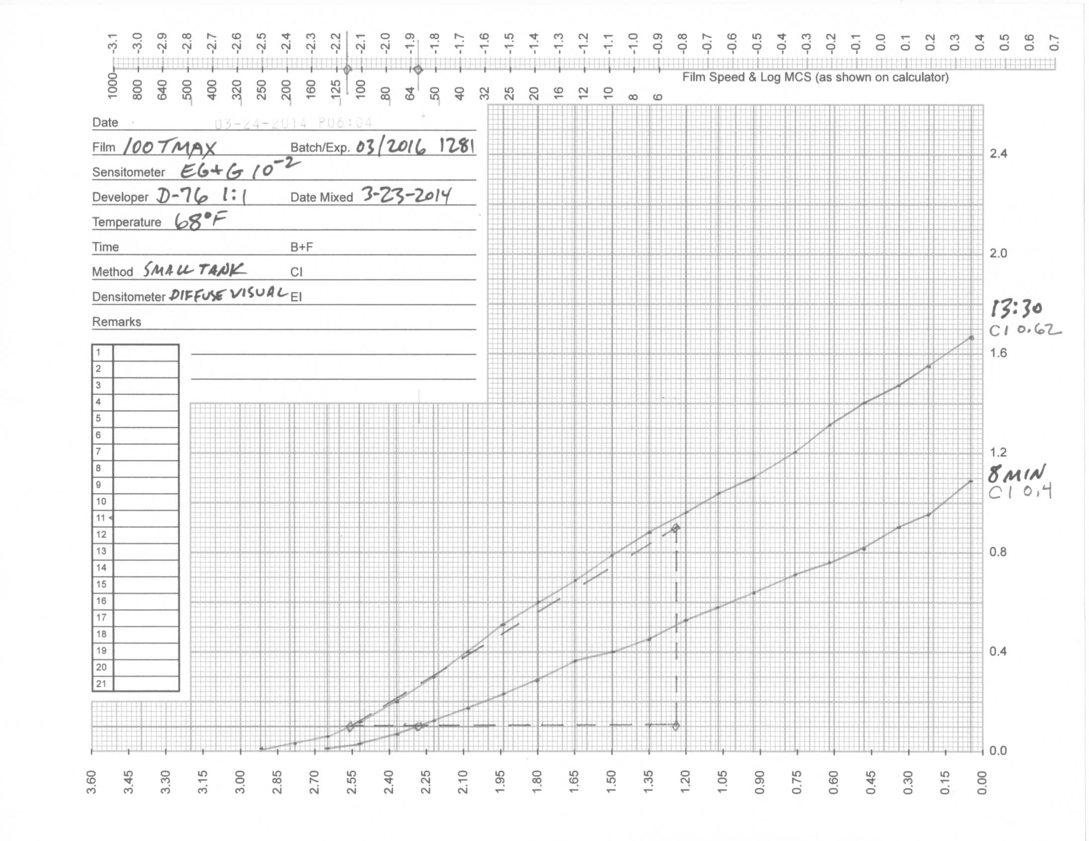

Here are the results of my test with 100TMAX and D-76 stock (1+0).
I've only drawn two curves here because I immediately saw something worth sharing.
Effective speed is indicated on my graph by following a straight line up where the toe of the curve crosses 0.10 net density.
At 13 minutes 30 seconds development time, I am very near the ISO parameters (dashed triangle) and very near ISO speed.
Notice I lose a full stop of speed when I drop from 13 minutes 30 seconds development time down to 8 minutes development time.
One thought I like to point out whenever talking about Zone System film speed tests... When you finally decide on development time for N, people often choose a development time slightly less than what meets the ISO parameters, so naturally the result is slightly lower speed (like 80 instead of 100).
I believe, Mario, that you also met the ISO parameters with your 12 minutes development time (I did a quick sketch of your data points and they look like if you continued the series it would achieve approximately 0.62 gradient).
You could take your findings as rock solid and run with 160 if you want.
And you don't have to listen to me on this point, but I would recommend calling your result 100 (trust that your lab technique is good, you hit the ASA triangle and manufacturer film speed is often our best benchmark)... Then note that your "system" seems to lead to +2/3 stop "error".
(I could also take my own advice and move my top scale to line up the ASA triangle with 100 for the same reason. But last time I moved the scale I had to move it back though).
