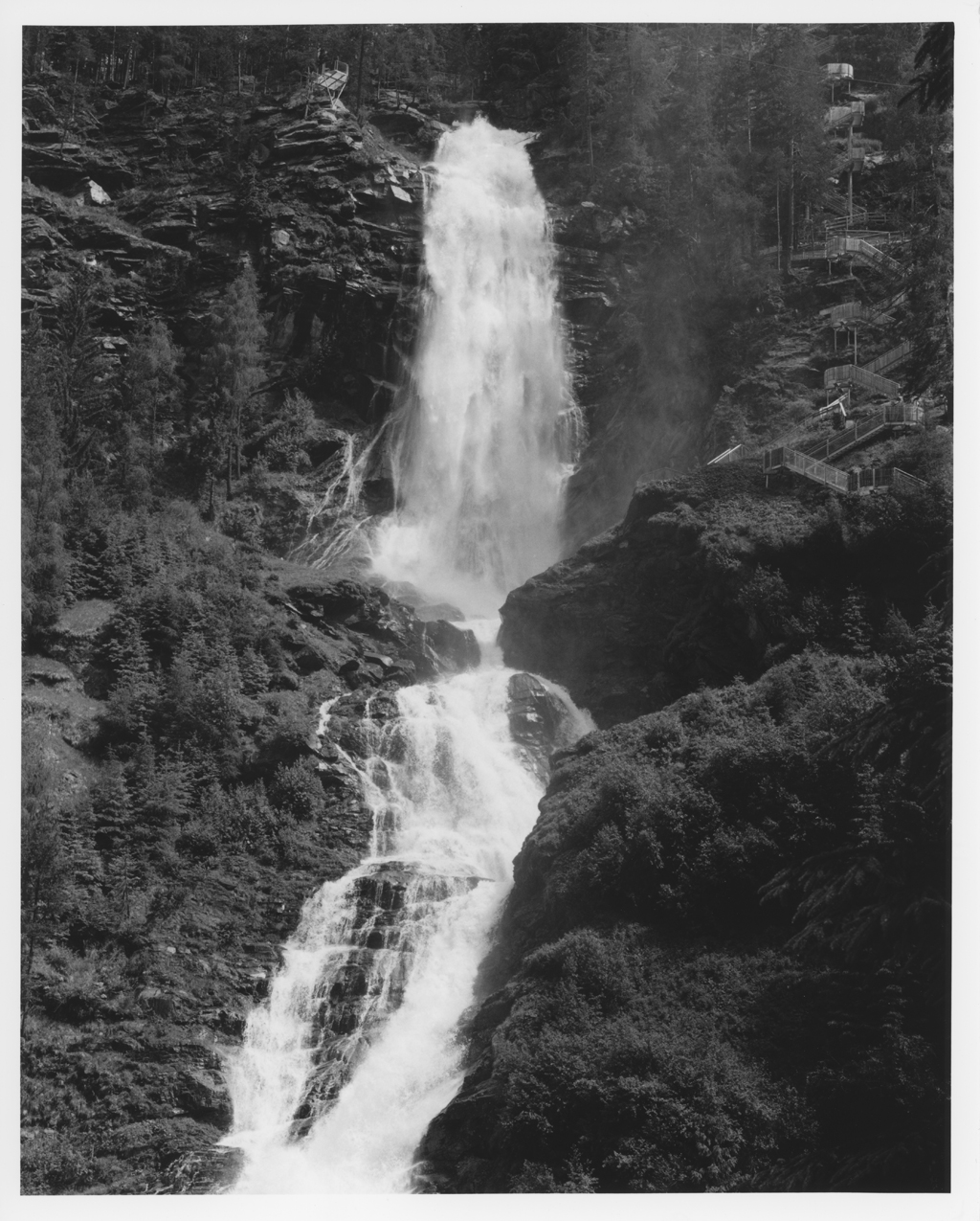

I've developed Delta 100 in DD-X and Xtol both 35mm and 120. The grain was very fine. Agitation 4 inversions at the beginning and then 4 at the start of each minute as per instructions. The inversions over a 10 second period.
This is 400 Delta in DD-X
DoryBreaux
DoryBreaux
Jul 28, 2017
55
Truckee, CA
Cant see this fullsize so I cant judge sharpness but thats a beautiful composition!

Svenedin
Mar 19, 2016
1,191
Surrey, United Kingdom
Med. Format RF
Alright then, guess I need to try it with proper agitation! Whats your method of digitizing?
It's a wet print that's been scanned so if you like it's already a copy of a copy. I do scan negatives sometimes especially if a negative gets damaged and I can't wet print it.
