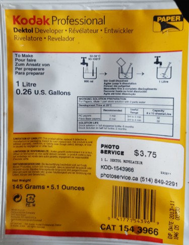

So far, the only available size is the one that gives 3 gallons stock solution. But i'll take a look at Polymax T Developer.
Just to avoid any misunderstanding, here's the picture of the Dektol bag that is not available anymore (so far).
In other words, the 1 liter stock solution
Understood - I don't think they are being manufactured in that small size anymore. The smallest is the size that makes 1 gallon stock (not 3 gallons).
