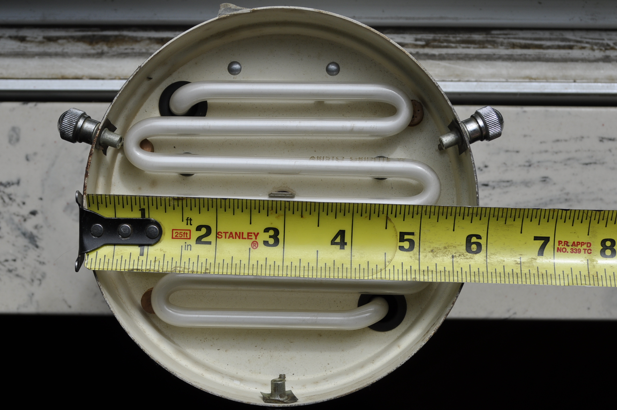

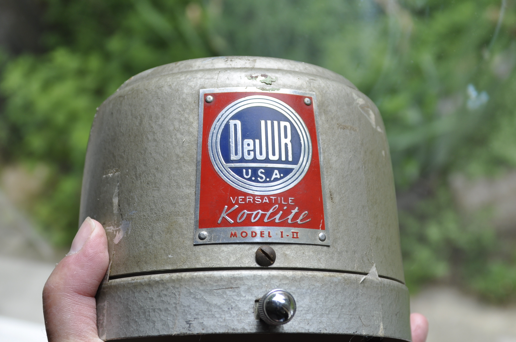

Years ago I found a DeJur Koolite cold light head at a fleamarket. I now have a need of a 4x5 enlarger and I'm trying to figure out what DeJur condenser models this would fit. Then I can begin a search for the model I need. Anybody know?
how big is it?---as far as I know there was only the "versatile professional" that was 4x5--I have one of these with parts from 2 others if you're interested--also have a medium format one--the versatile II
pleaes email me if interested: johnielvis@aol.com
I believe it's big enough to be 4x5. I'll measure it and get some pics of it, maybe you can tell easier that way.
Here's a couple of shots. It's a little beat up, but it works fine. The inside diameter of the head is approximately 5 13/16". The nameplate on the front says 'Versatile Koolite Model I-II'. Does this fit the 4x5 Versatile Professional?

oh--that's easy--Idon't even have to go to the storage to measure---
the diagonal of 4x5 is about 6.4 inches..so that will be for the smaller model--possibly the versatile II that I have--that's a 6x9 enlarger--that I'll measure and see but for sure that light you have won't be big enough fo ANY 4x5 enlarger
Dang. I already have an Omega C760XL that I can print medium format with. I need a 4x5 enlarger now.
oh well...you're better off with a regular condenser anyways---oR--if you must have cold...put in a cfl or one of them new led floodlights with no condensers in it...that lookslike it'll work.
