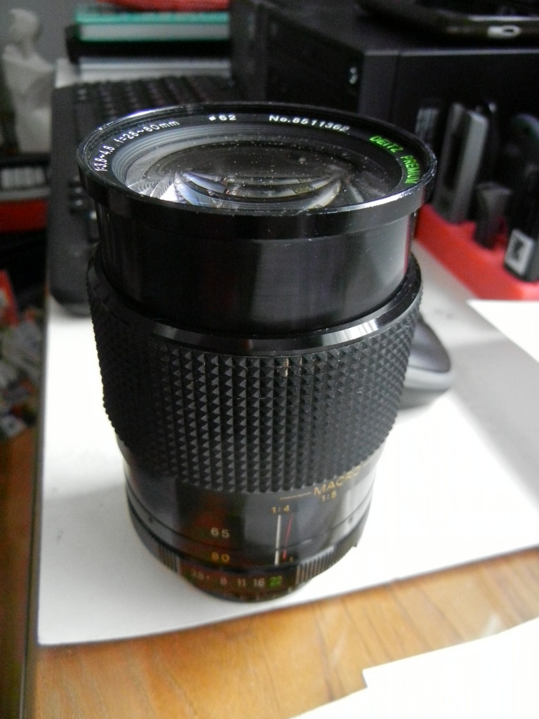

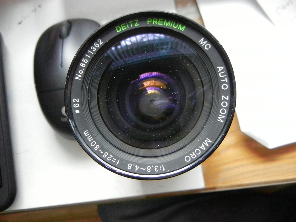

I did a bit of digging. There isn't much information on this, so I think putting it here might help.
It looks like the lenses were made by Makina Optical in Japan. So I figure they are probably built in a similar fashion.
Anybody ever took apart a similar Makinon, Makina, Hanimex or Vivitar zoom lens? (They did make lenses for all those manufacturers and more)
Here are pictures of the lens in question.

Few people, if anyone, know how to repair off-brand lenses such as this one, so you're probably on your own.
I suggest first removing the rubber grip around the focus/zoom ring. That will probably reveal some slots or holes through which you might have access to some threads that can be oiled.

I must admit that I was taking a chance. Thing is, I got this lens for super cheap and I feel it's a good candidate for learning how to repair zoom lenses.
I took off the rubber grip and there are holes and screws hidden under it. I was lucky in that the grip wasn't glued into place and was still quite flexible.

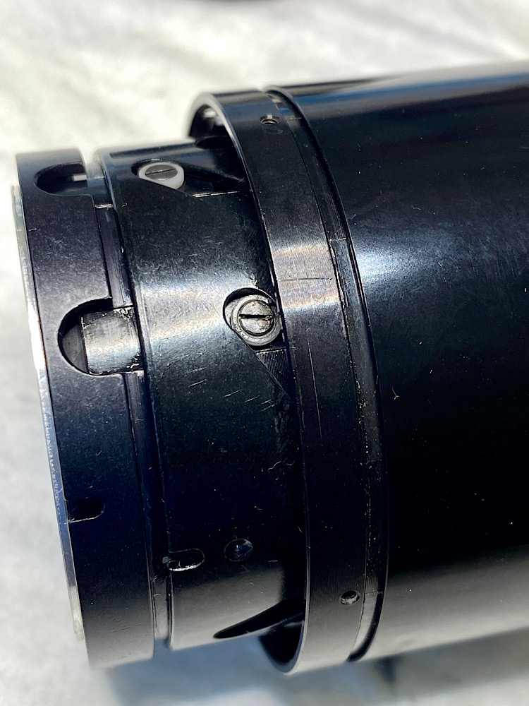

Cleaning and greasing the helicoids of a lens can sometimes be done while the lens is still assembled, i.e. the helicoids are not separated. This avoids any problems with adjustment.
Pour lighter fluid into the helicoids, move them, let the oil/lighter fluid emulsion run out and repeat this several times. Then pour grease into the helicoids.
It depends on the lens whether this is possible; the helicoids must be sufficiently accessible and the optics should not become dirty in the process.
Here is one of my projects where I did this.
All information provided without guarantee and use at your own risk 🙂

You can see the plain bearings in their open guides if you expose them, e.g. by removing a tube above them. They should be fixed with a screw, so you can remove them.
I was lucky once and plain bearings that I had removed from a third lens and kept as spare parts fit on another zoom.
If there is something from China, I would buy it, you can't go wrong.
