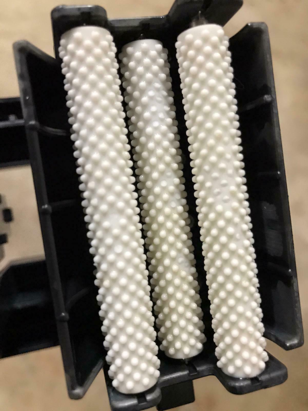

Something like this from a Noritsu film processor.
foc
Jun 30, 2010
2,527
Sligo, Ireland
The dimples are like tiny pin pricks, but in small patches. That pic would create way to big impressions.
