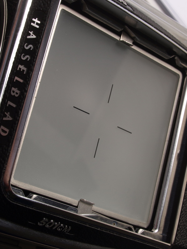

Hi,
I am considering buying my first Hasselblad (body and lenses). I saw a good 501 CM from early 2000s, but I am a bit hesitant as it come with the "stock" screen [UPDATE: it looks like it's not not the stock screen but an older one, presumably replaced by the previous owner]
I have read in various places that an acute matte screen is (much?) brighter and most reviewers recommend getting one. I also understand that the old V series models had a relatively dim finder screen, but things had improved with later models.
So my question is, how much of an improvement is an acute matte screen versus a later 501CM stock finder? Is it worth the extra bucks/quids?
I am attaching a photo of the actual finder.

As far as I know the "stock" screen for the 501CM should be the Acute Matte D. That is the latest and greatest and it is one of the brightest screen I've ever used. Not sure how you recognise one over the older ones, I think the D has some notches on the metal frame or something, can't remember.

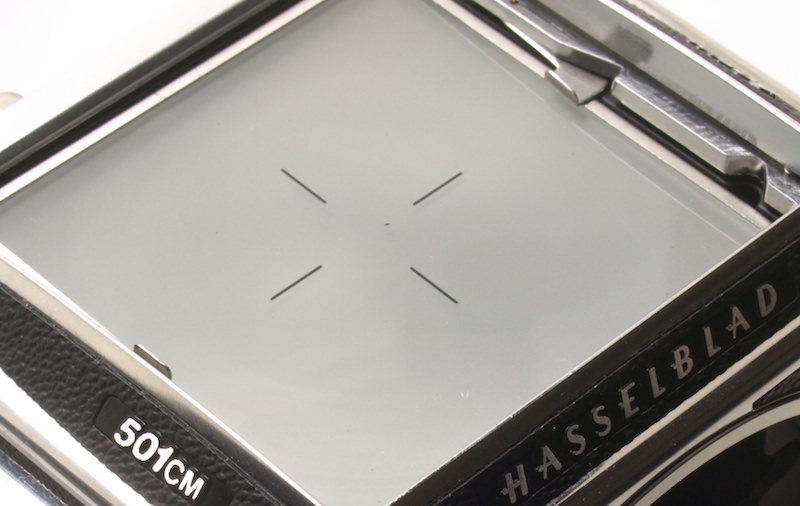

Hi,
I am attaching a better photo of the finder.
Seller says he's not sure this was the stock one, previous owner may have changed it.
Anyone can help identify which version this would be? I don't see any notches on the frame.
Thanks

That’s an older stock screen. It is “okay” in bright light. My 500 c/m had that screen when I bought it, and I’ve since changed it out for an acute matte D screen. Much much better. Worth the money.
The older screens had the “+” in black. On the newer acute matte screen, the “+” is etched and not painted.

The Acute Matte D have two little notches in the metal frame, that is not the original screen that came with the camera. I would expect to pay less for the camera.

This is an older screen. You can distinguish it very easily from the Acute Matte (D) because the cross is painted, while it is etched in on the newer screens. If the camera is in good shape overall, I would ask for a 100-200 GBP price drop, depending on how reasonable the price already is.
