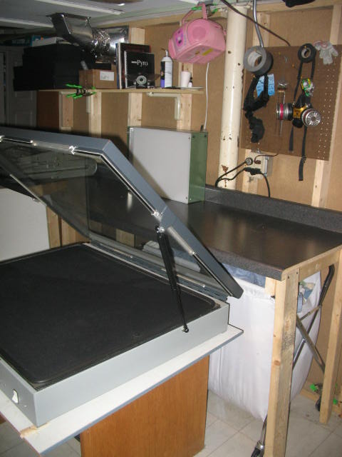

Heres my first darkroom, enlarger free, Before this I used the schools fracilities. I contact print 11x14 and hoping to add 8x20.
