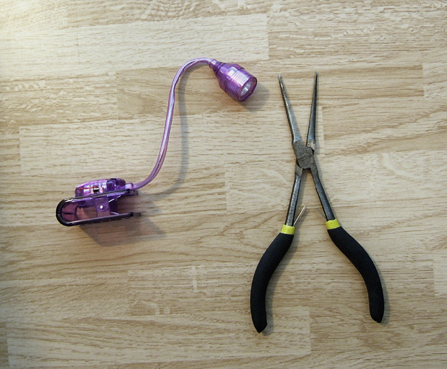

Like David, I use a pair of needle nose pliers that have long, slender "arms", for lack of a better word. I filed each to a point. Bought them from the Dollar Tree about seven years ago for $1. Haven't found any camera lens that I couldn't take apart w/ them, nor any shutter ring that they wouldn't remove. I also found this neat LED light w/ a flexible stem there too. Perfect for finding light leaks in the bellows of folders. The pliers are a lot bigger and more robust than they look in the pic, and they will not bend, even w/ lots of pressure on them.

Thank you, momus, for legitimizing what I was afraid would be negated as not feasible.
IT WORKS. And, MOST importantly, photo items bought in stores that are not 'photo dedicated' are the best buys, by far. Also, in Philadelphia we have Dollar Tree. Years ago, they had sets of miniature screwdrivers, both regular and Philips, for only $1. I bought a dozen sets for posterity. You do NOT have to spend tons of money. - David Lyga
