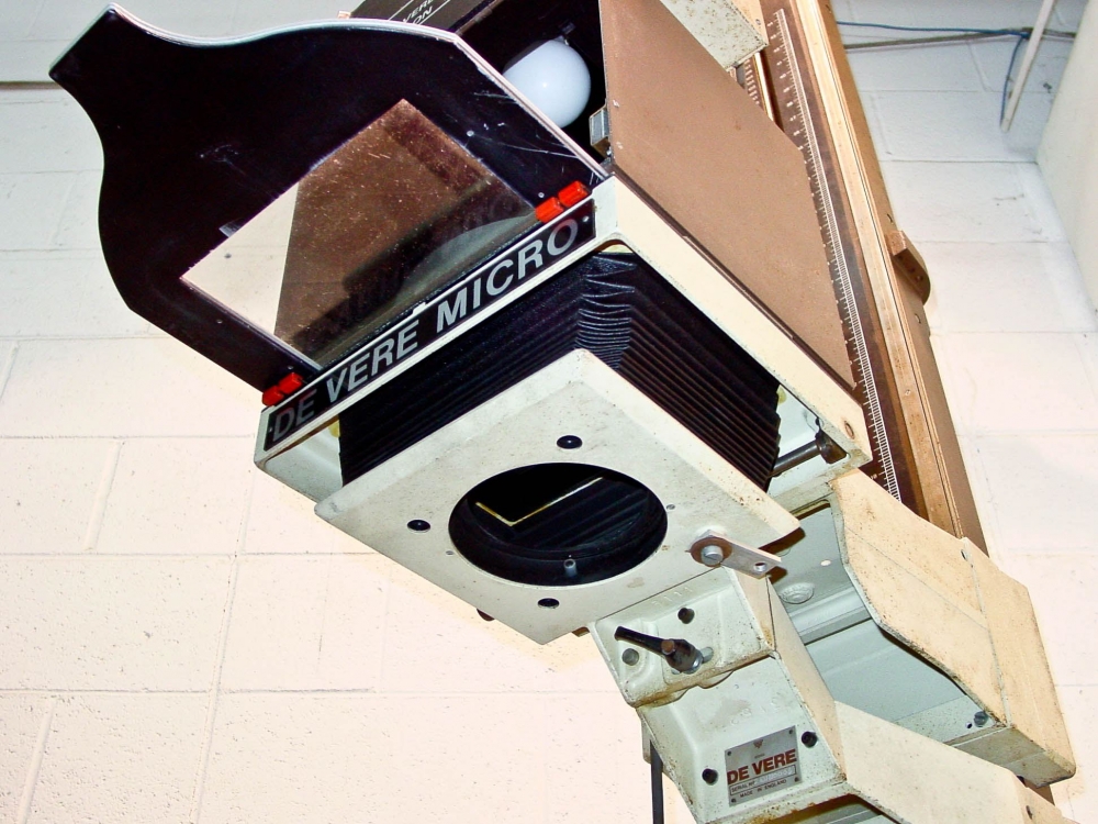

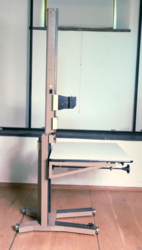

I bought this and perhaps wish to return it to its original use. At present used as a copy stand. Would the parts of a 504 work? Really seeking opinions and ideas.

The only thing that may change is the head mount, and that should be easily solvable. I don't have the vertical enlarger anymore, nor the manual at hand, but what you want shouldn't be a problem.
