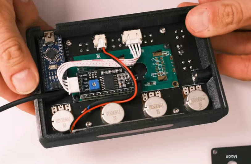

Intrepid uses an Arduino. Here's a screen-grab from a review on Youtube:
The Arduino is at the upper left.
Here's the link to the review:

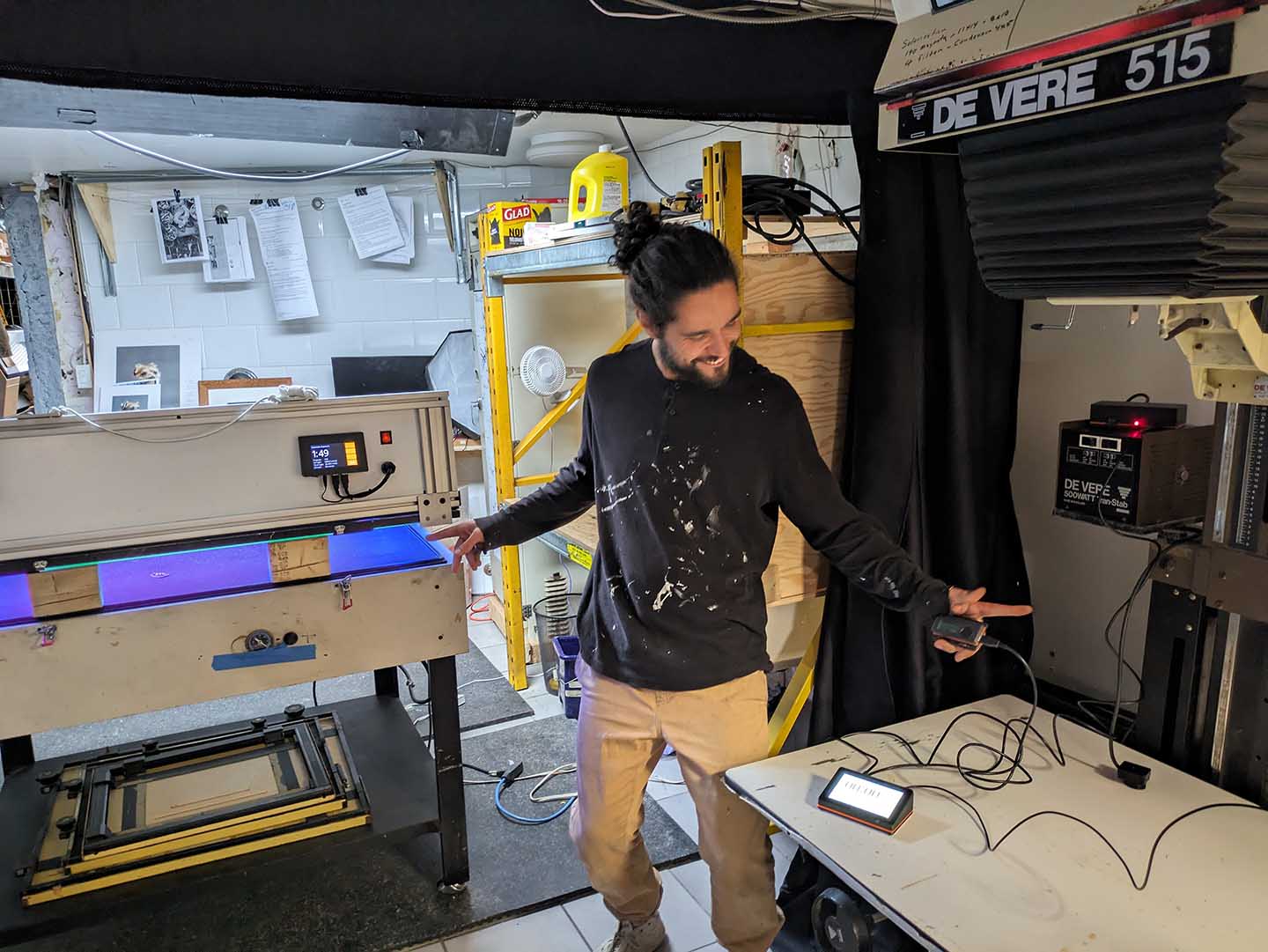

On the topic of DeVere enlarger adaptions , I just had Ian Leake provide me one of his amazing timers with cables to hook up to my 11 x 14 Devere transformer, I have two Devere Enlargers
and in both cases the timers were becoming wonky, I. love the adaptation. An UV timer drives my UV exposure unit and now Ian is making straight timers for Enlarging work.
