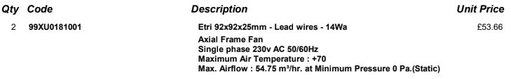

I looked into this quite a bit when restoring my 507 dichroic enlarger. In the end I've decided to grin and bear it. If I want a silent head I'll opt for a condenser setup. Though, after thoroughly cleaning the fan units, they were quieter, but unfortunately the bearings for one unit is on the way out.
Following from Ian's advice, you will also need to consider the flow rate of the unit. I came across many fan units simply did not have sufficient CFM.
De Vere used a French manufacturer called Etri for their fan units. You can get like for like replacements, but be prepared for both the cost and time delay. The supplier I was in touch with noted a 12 week turnaround, due to Etri's manufacturing cycle!
To get you going, see attached the fan unit for a MK1 'bread bin' head (British voltage).
Hopefully you'll never need to replace the bearings for the lens and negative runner assemblies, otherwise you'll need a machinist and some deep pockets! It's doubly painful if you have a floor standing unit with a drop table.(In this rare instance having it serviced by Odyssey may be worthwhile.)
I had a crackpot idea of writing a self service manual/restoration guide for De Vere enlargers. If anyone thinks such a document is worth putting out there let me know.

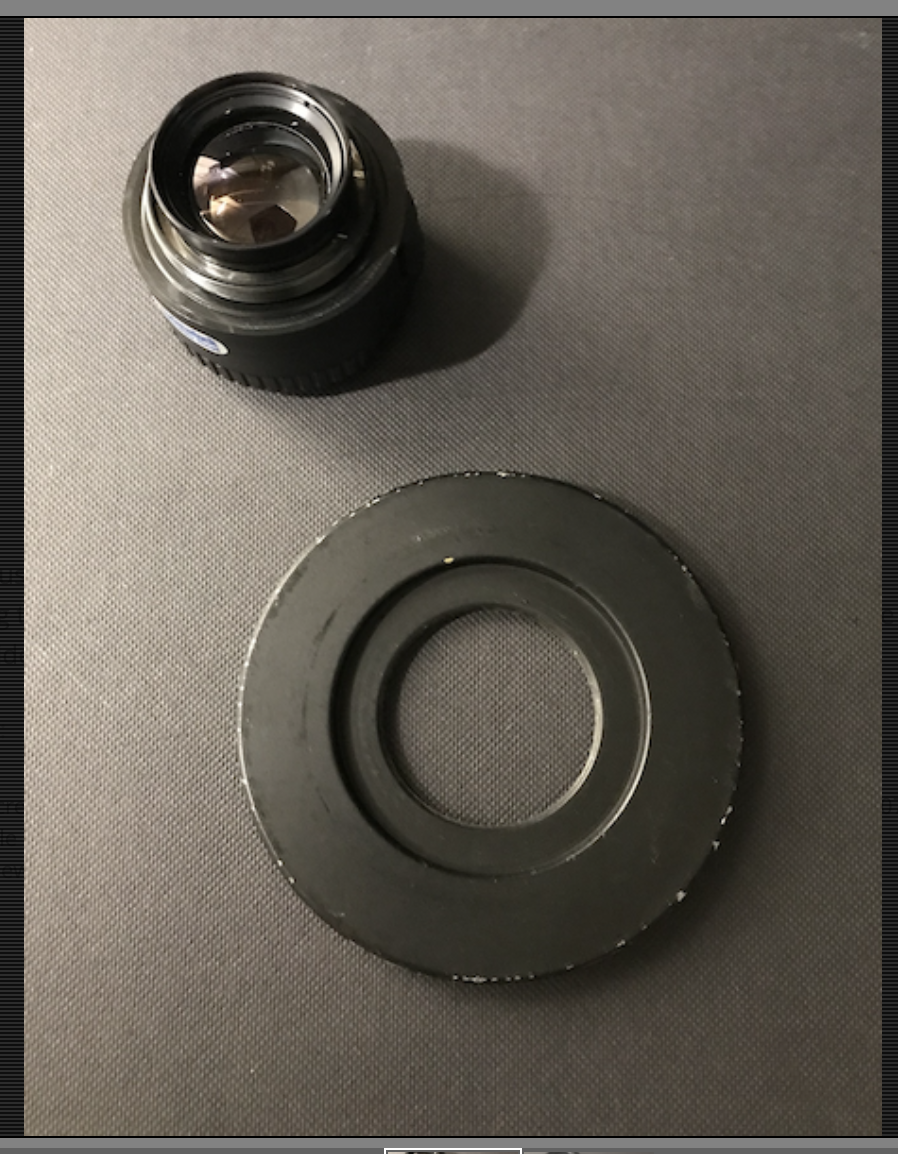

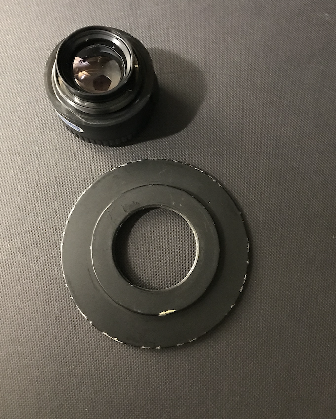

Hello De Vere users! I have a simple question and though I would write it here.
When inserting the lens in the lens panel of your De Vere, on what side do you insert the lens?
The concave side ( as in the first image ) or into the other side ( second image) ?
What focal length is it? I'd probably use the recessed side if it's under 80mm.

On my 105mm and 150mm lenses I have the flat type plate like what you have shown, both have the lens attached on the flat side with the retaining ring sitting inside the recessed portion.
The plate for a 50mm lens is quite recessed, far more than what is shown here; the 50mm lens sits inside the recessed part.
Mick.

@Mick Fagan - Are you sure that you aren't referring to the boards for the 504 & bigger machines? The recessed board for the 203 is meant for 28-35mm lenses for 1/2 frame etc - everything else in the 50-105 range goes on the flat board.

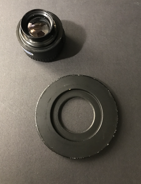

Thanks a lot for your replies. I use that lens panel that I showed in the photo for 50mm-105mm lenses on a De Vere 203.
Just to double check, according to what you are saying, the one below is the correct side on where the lens should seat.
Cheers!
For 50-80mm, that's what I do - longer, I use the other side. I'd need to check the manual to see if there's any instruction as to the 'correct' way round.

@RR10 - The manual implies that the lens should go in as shown in your picture - which is fine, unless you want to put a lens that's too fat for the recess on the enlarger (if in doubt, assume that De Vere used the dimensions of Rodenstock lenses for working out any clearances etc).
