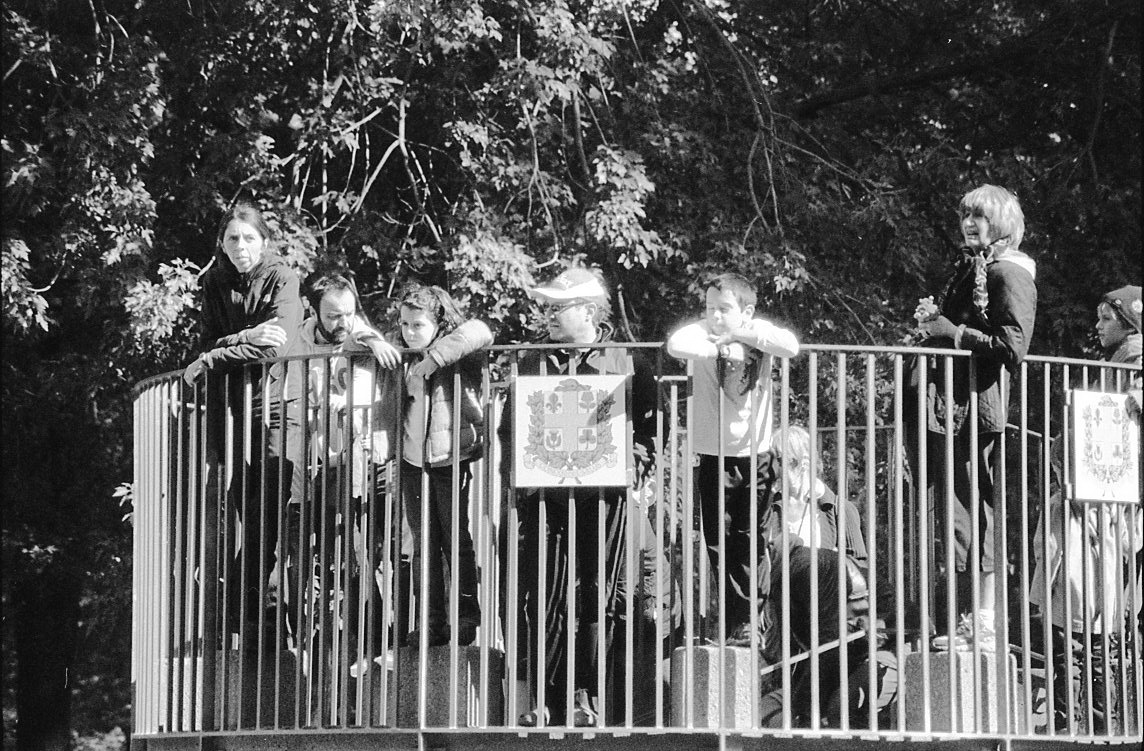

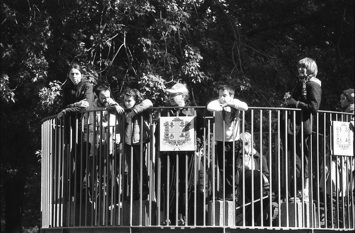

Dazzling light on a picture.
It is a very ordinary picture but that doesn't matter regarding the issue.
The dazzling effect gets more important when I push on the whites while processing it thru LR2.
I need your opinion. Personnally, I tend to believe the Fomapan doesn't have the anti-halo protection.
Nikon F80
Fomapan 400
Rodinal 1:50
the flat picture
after a little LR2
I don't see halation.
I see over-exposure of the highlights.
Scanning plus digital manipulation makes the over-exposure look a bit like halation.
IMHO, even the picture #1 seems to show some dazzling light (especially the shoulders of the little kid). I have never had such effect on my shots before this serie.

Good thought, but all digital manipulation is off topic here at APUG.
BTW, the halo you are seeing may actually be lens flare or Light Room guessing and have nothing to do with the film characteristics.

I think that is a darn good guess.
I'm not entirely convinced either. As Matt said, it's easy enough to manipulate something to the point you're convinced you see something.
To me there almost seems to be a slight bit of "halation" in the original around the boy in the whitest sweater's shoulders, but it's more likely due to overexposure of the whites and scanning than the film base itself. And even if not, I don't see what difference it makes if you have to overexpose and then blow out the whites even further just to see it.

The first picture, as I previously said, is scanned without any special light adjustment. It is just a regular scan as I do plenty of them. In the second picture, I just pushed the dark tones and did not push any whites.
I've seen halos like that when the coating on the front element of the lens was damaged. Or maybe the lens needs to be cleaned. A fingerprint perhaps?

The artefact at the boys shoulder could be due to partial body movement.
Halation ot this point of image would be symmetric.
