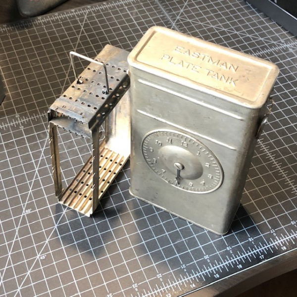

The only one I have ever seen that needs to be used in darkness is this old Kodak tank for developing plates.
