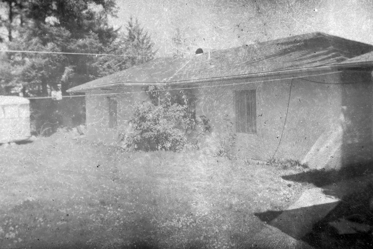

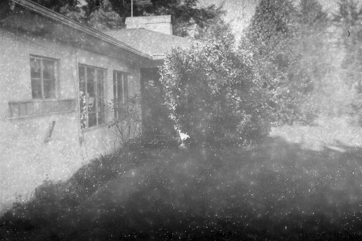

Well, I got the film home and developed, but the results weren't nearly as impressive as the ones above. I'm guessing that film had been sitting undisturbed in the camera for a good long time with the emulsion degrading, even though the backing paper looked great. The film has the same edge markings bvy described---"Kodak Safety Film", with "Film" in an elongated triangle. The backing felt thin, like old film-pack sheets. I put it through HC-110 dilution E for 8 minutes at probably 70-72 F or so.
Fog levels are low, but the images are quite thin with nothing approaching a good solid black anywhere on the negatives (even the edge markings); maybe I should have let them cook longer. It looks like the first three frames were shot normally, the next three were probably wound past and never exposed, and the last two were exposed idly by someone messing around with the camera (they show indistinguishable blurs). Interestingly, the last frame is *almost* discernible, with a lot of manipulation---it's really blurred, but I think I see the front of a house and a person standing in the door or window.
The best two frames are attached. They show the exterior of a house that could easily be on the Oregon coast where I found the camera---the vegetation seems consistent with that. No real clues as to who, where, or why.
