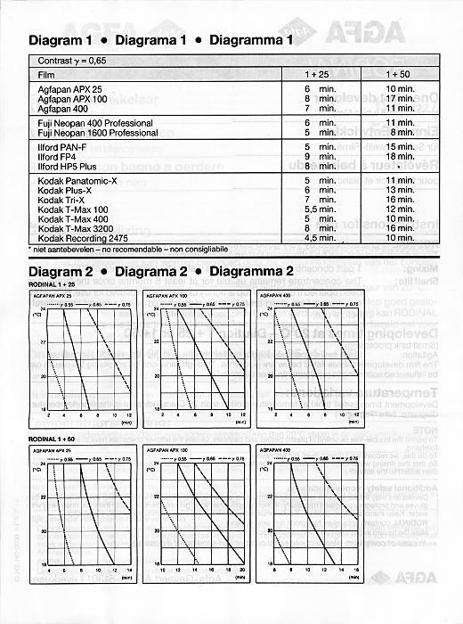

Stumble upon this old discussion and thought that i could contribute to some other reader.
Here is a page from a more than 15 year old datasheet from true Agfa Rodinal, it does differ a bit from those in this old discussion. The times are shorter, except for Kodak films(??).
