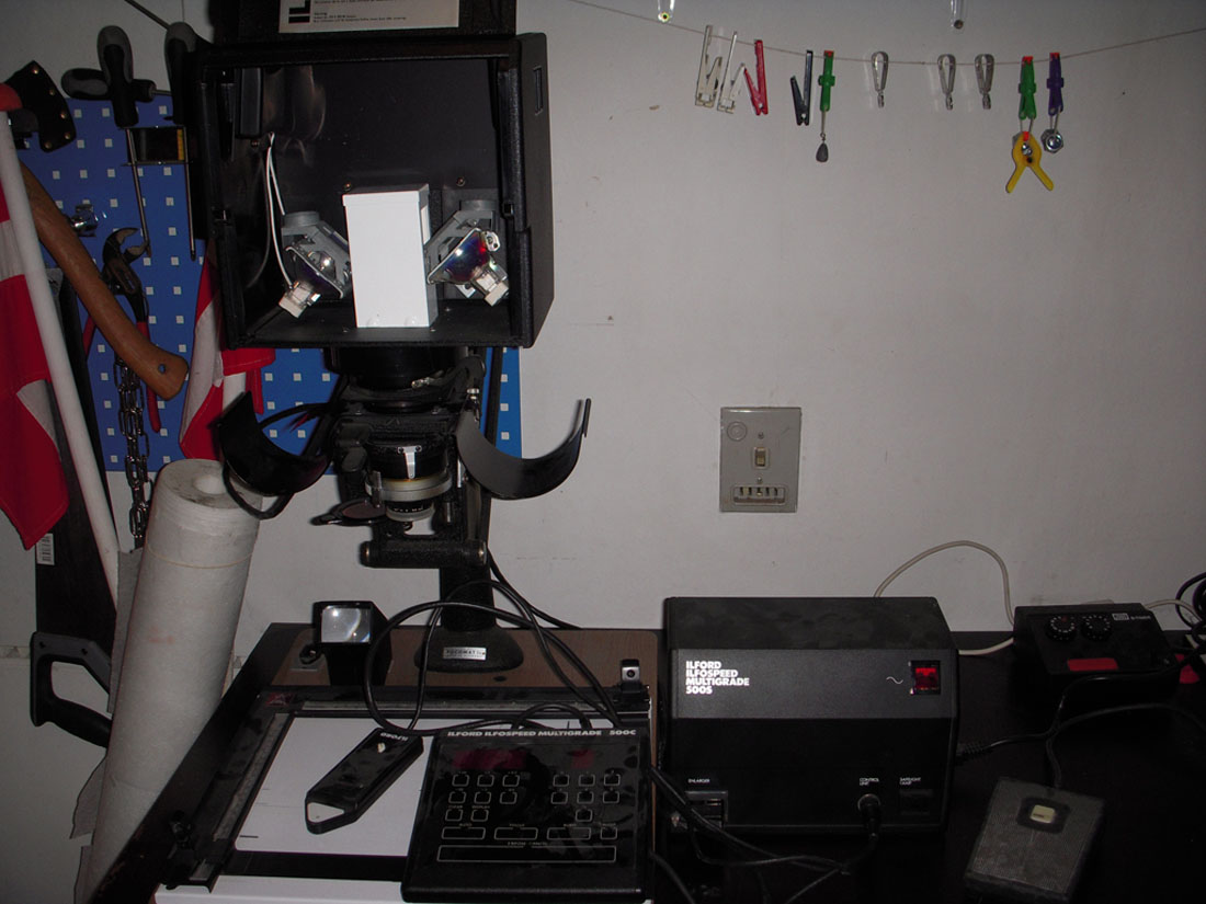

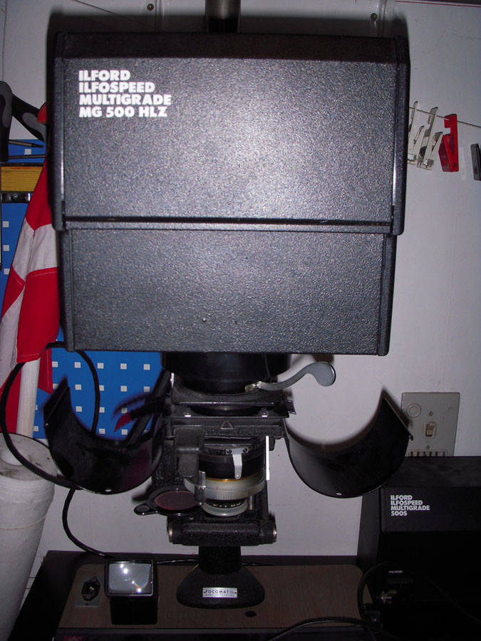

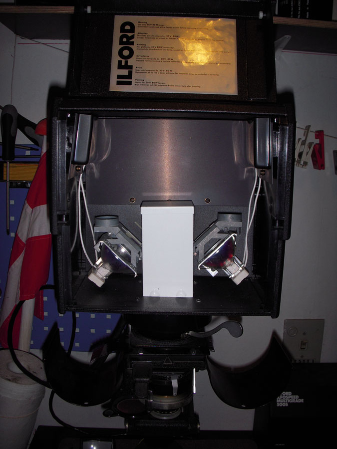

Ilford MG 500HLZ pictures
Finaly I got it home and put up, eager to work with it.
Shot some pictures of it.
Jesper

Hello Jesper, that looks fine! I didn't know a head like this was made, thanks for the pictures.
Indeed without ventilationfans as DAP said. That's not bad you know, one of my MG500-heads develloped an unbalance, and that means vibrations.
Enjoy the beautiful enlarger :smile:

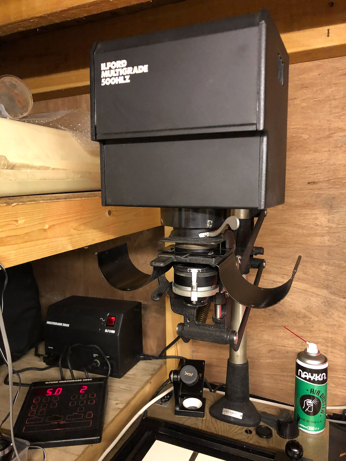

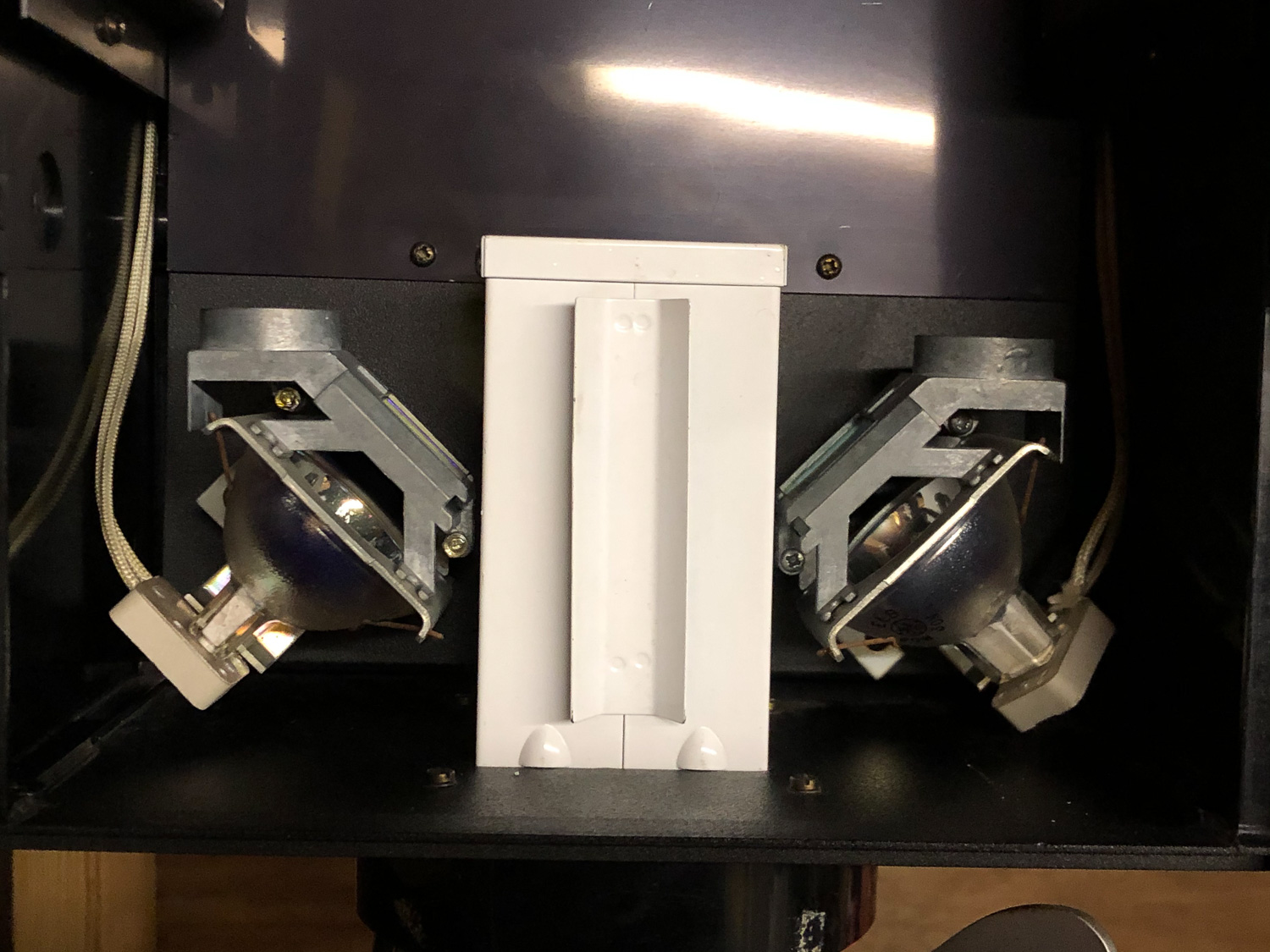

Jesper

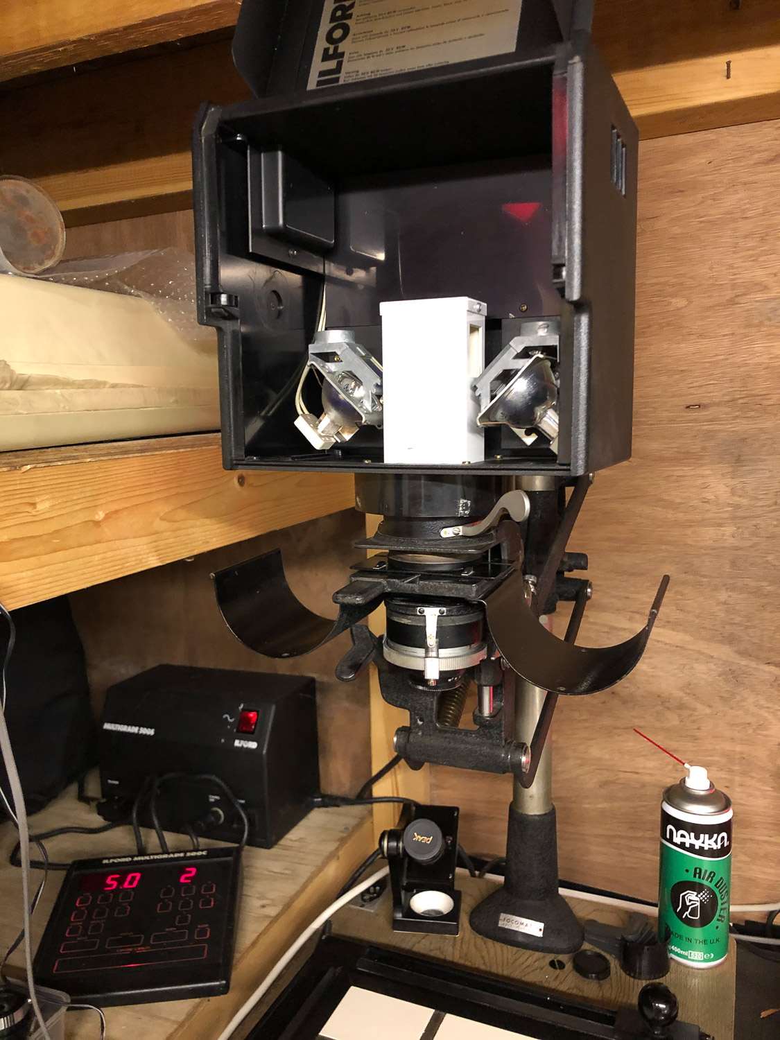

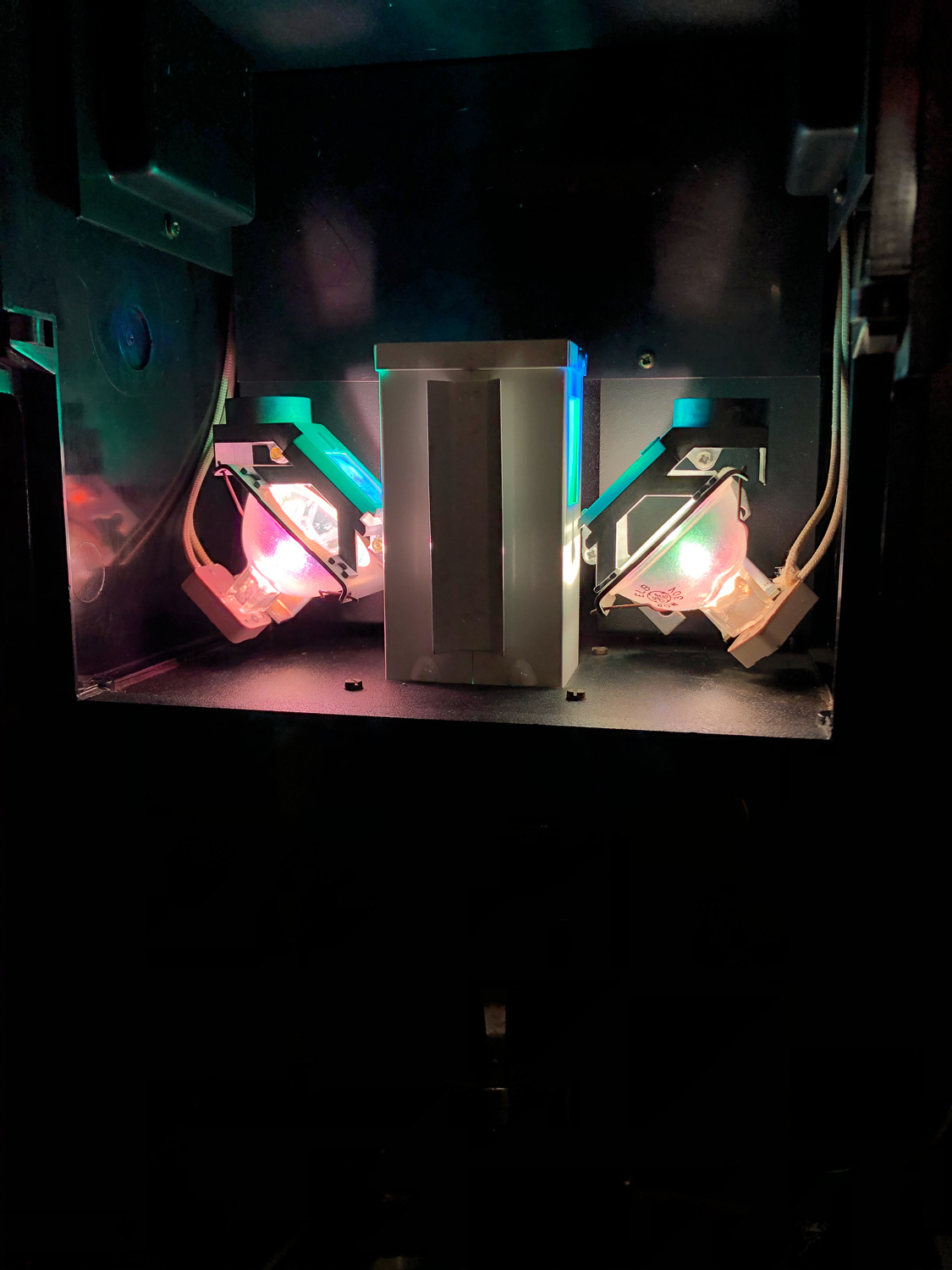

Hello Jesper,
I know this is an ancient thread but on the off-chance you (or anyone else) is still watching...
I am also the proud owner of such a setup. I wonder if I could compare notes with you: I find the image very dim and wonder why. I have the correct ELB 30v/80w bulbs and they certainly look bright when I lift the cover. I am getting exposures of 20-30 seconds when my Valoy with regular incandescent bulb (75w) needs 8-10 seconds. Is this your experience or is there something that can be done to enhance the mixing box or perhaps new heat filters. I understand Schott makes heat filters that transmit another stop of light compared to the old Ilford ones. I am not keen on dismantling the interior of the head though!
Tks
Adrian
