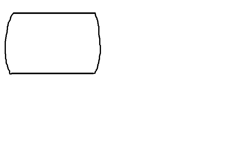

You could try making the vertical edges of the holes slightly rounded (wider toward the center) such that the light seal isn't fighting against a flat edge. Even then you'll probably wear out the seals much faster than using regular slides. However, that may not matter since you'll be saving quite a bit of money on film tests so sacrificing a film holder is probably worth it. Anyway, the rounded trailing edges should mostly eliminate the sticking issue.
Sorry for the lousy drawing...
