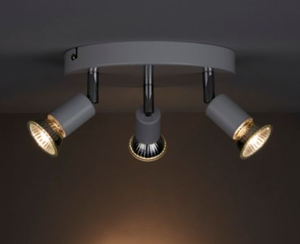

I have two 3 lamp spotlights in my darkroom - like these.
I have one bulb pointed at the first fixer bath, another at the wash bath, the rest to other key areas like where I retouch trim and frame etc, They are about the same distance as you'd use to illuminate prints in a gallery. Currently they are halide bulbs but when they need replacing I'll switch to LED. These are on a pull cord switch that stretches across the darkroom so can be turned on/off by the enlarger of by the ewt bench.
The main lighting is a fluorescent 4ft tube but this will be replaced by an LED equivalent soon.
