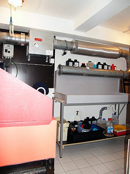

You may be interested in looking (there was a url link here which no longer exists). It's my solution. You will find a source for components too.
Ulrich
