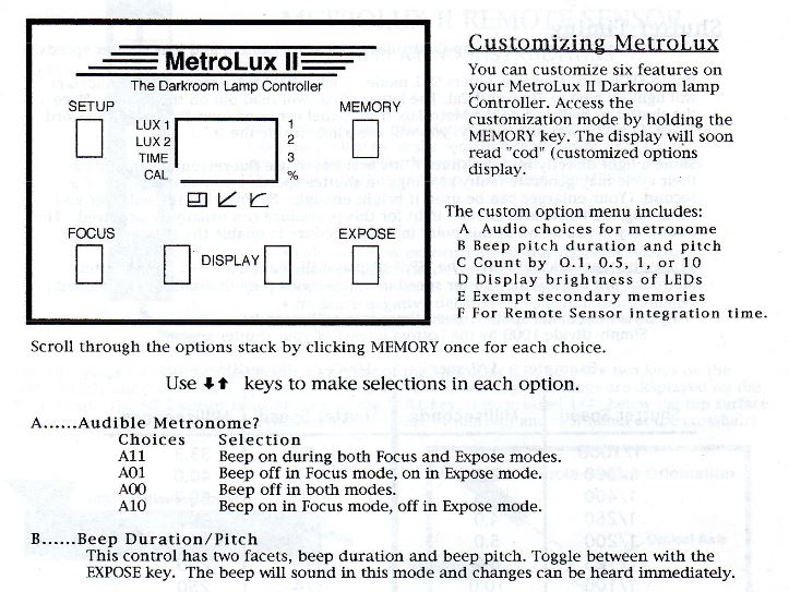

The Metrolux beeps by second during exposure (and other combos). Very intuitive to use, too.
