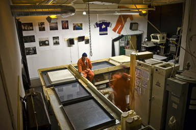

Have you tried use Kitchen equipment stores, they usually have tons of used stainless sinks, trays and large venting systems that go for excellent prices.
I can email you a jpeg of our venting system if you want , it is basically a very large tube running the whole length of the darkroom , in a L shape, the only holes are at the bottom of the tube , and this is then hooked up to a very powerful exhaust fan.
works well for our enviournment , specifically when I am sepia toning and the whole room smells like the back end of a cow.
I think any competent construction worker could put this together.

Bob, can you send me your photo, I am interested in building something. Or maybe post it at APUG so others can view.
Thanks

Okey Dokey
You can see it entering the room, from the left, this photo was taken before it was finished, It angles to the right across the room above the sink.
Large holes are in the bottom about 10 inches apart and there is enough suction when on to pull paper into the vent.

Holly smokes, where did you get that miniature man sitting on the sink?
Or, those sinks are really huge!
Hard to see in the photo but I will try to enlarge it.
Thanks

OK, I enlarged it, but don't see any thing with holes in it, or anything near the sink. Probably just me and staring me in the face.

Top left is the incoming exhaust vent , read my earlier post and you can visualize what I am talking about.
